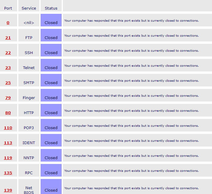

I’m using a CRS326 at home. I notice when i run an external scan of my IP address that although i have no ports open, the firewall is not only dropping packets, but is replying with ‘port closed’.
Is this normal behaviour?
Is there a way for the firewall to drop packets silently? (this is what I’m used to with my old Draytek)

this is what ShieldsUp shows…
Shields up is a very nice but not required, I believed you the first time,
what is needed is to see why your config is letting that happen :slight_smile:
/export file=anynameyouwish (minus switch impersonating a router serial number, any public wanip information, keys etc.)

My experience is that FW with drop rule does successfully hide port (it’s “stealth”). If, however, port is NATed (for a particular source address), then it’s up to service on the backend to handle “unwanted connection requests” … and mostly they respond in a way interpreted as “port closed”.
But yes, it really depends on how FW is set up.
