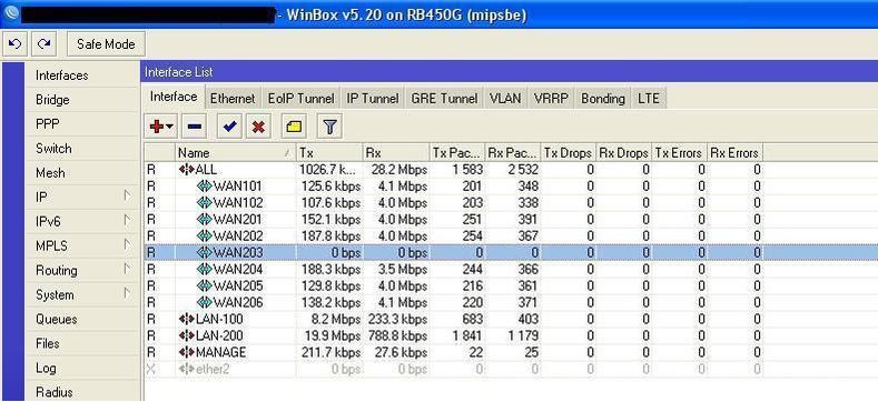

Hello everyone,
I found one who says that he can make load-balance to unlimited routers (gateways)
on a “single LAN port” with the rb450g.
He made load-balance between 7 routers every one has 4MB download speed
so that’s equal 28MB of download speed,
and he made one other LAN port take the speed of 8MB and other one 20MB
and you can see the attached picture
and he also disabled one LAN and name one LAN “MANAGE”
So if any one know how this can be done please explain it for me.

i think that the LAN part of the routers is conected via a switch to the WAN part of the rb450g
Thanks for trying to help, but I think he uses VLAN(s)
I’ve new info :he put all the routers in a “manged switch”
