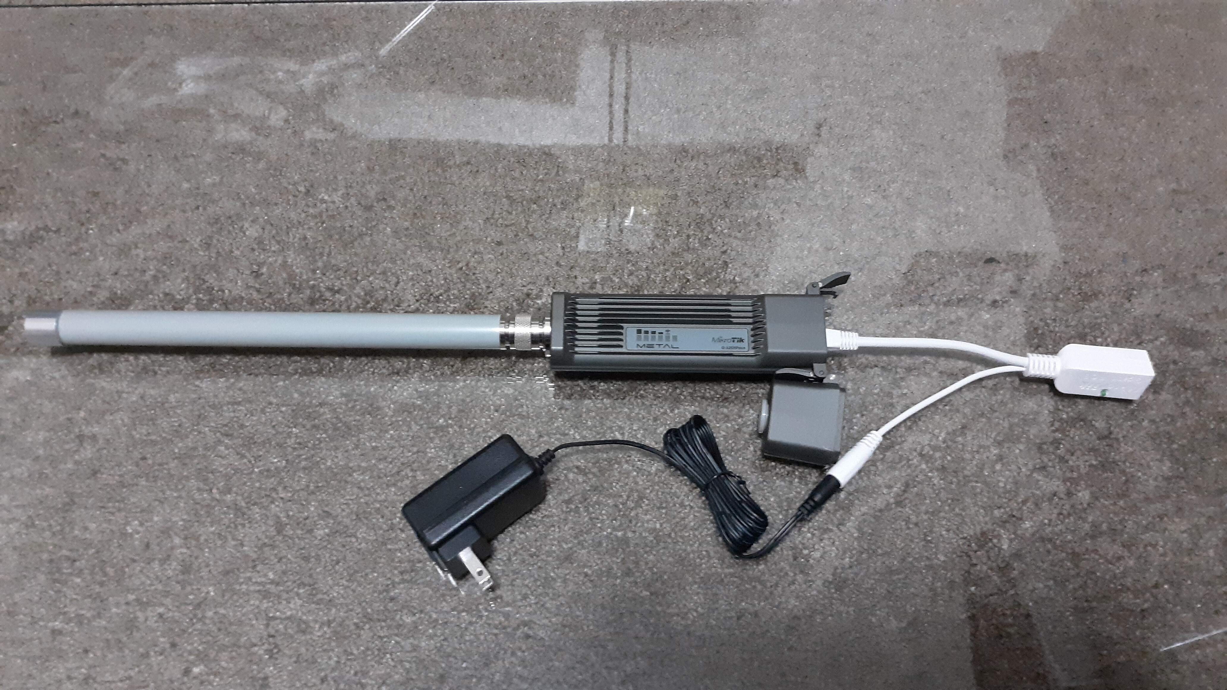

Your POE Injector is placed upside down… The POE Injector has 2 arrows from one side, showing the direction of POE and Data, that goes to the antenna and one arrow showing only data and that goes to your Router or Switch etc…
So you cant possibly have set it up that way at all…
No sir, I did not set it up that way, that was just the first picture I took out of the box.
I did turn that around before plugging it in and programming it.
Sorry for the confusion.

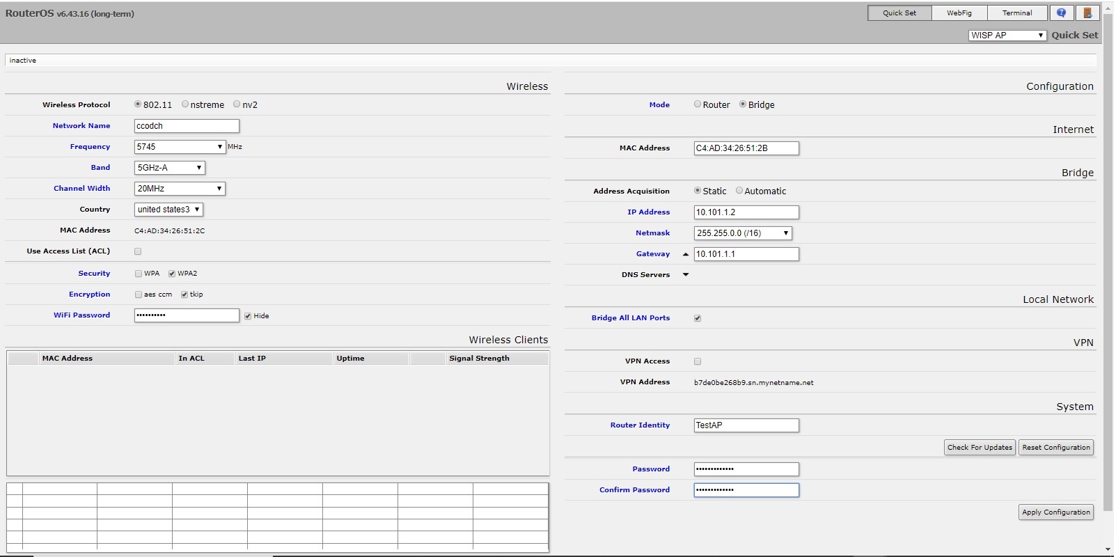

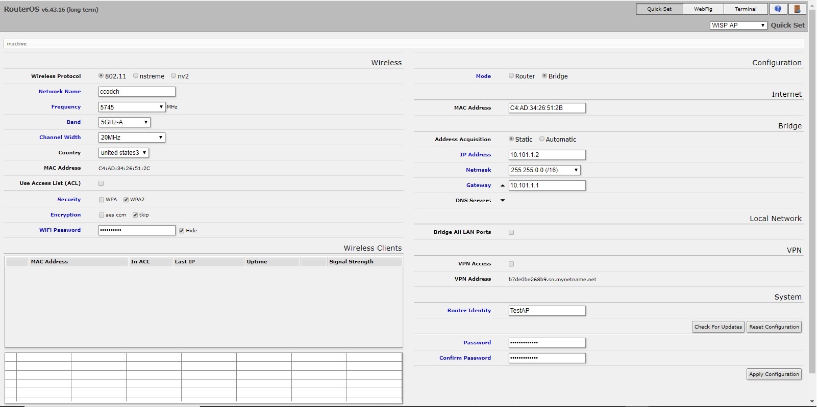

I reset the radio again, set it up with Webfig to be an WISP AP again , and now I can only get to it from Winbox.
I have attached the AP radio settings in Webfig just before I saved them.

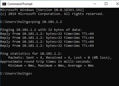

You changed the IP address from the default 192.168.88.1 to 10.102.1.2. Can you PING that address?
Yes, Sir.
Ping is good, and constant.
Enable Bridge all LAN Ports

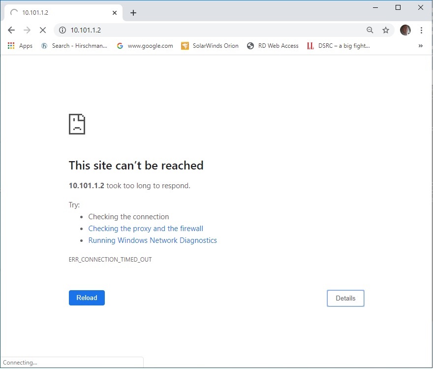

This time with Bridge All LAN Ports enabled, I can still ping it afterwards with it’s new IP, but now I can’t get into it with Webfig, or Winbox.

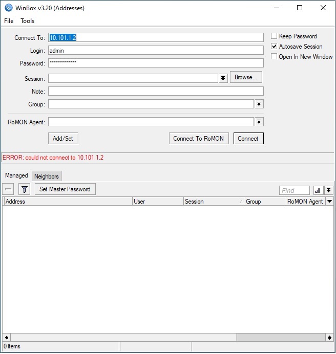

I can’t login with the IP or MAC. It just won’t connect now at all.
What is the ā€œNeighborsā€ tab showing in WinBOX?
If the MKT device is there, click on the MAC address , then connect.
Strange that you can PING, but no other access. Looks like you connect via an interface that is not in the LAN interface list (in the WAN interface list?)
Try also Telnet and SSH. (PuTTY is a possible tool for this).

Did you tick ā€œBridge All LANā€ Ports?
That did it Pamela!
The first time it did not, but when I tried it again with Bridge All LAN ports, it’s working perfectly!!!
