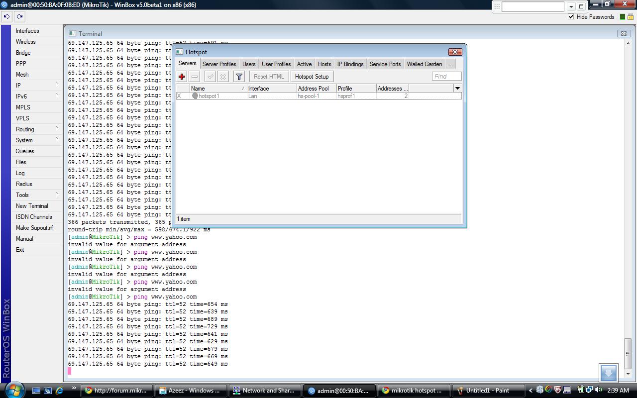

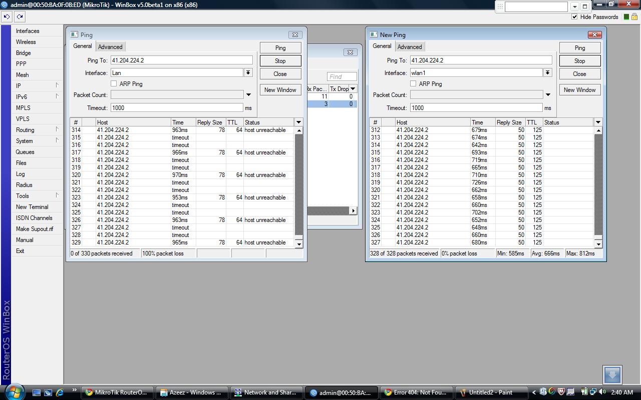

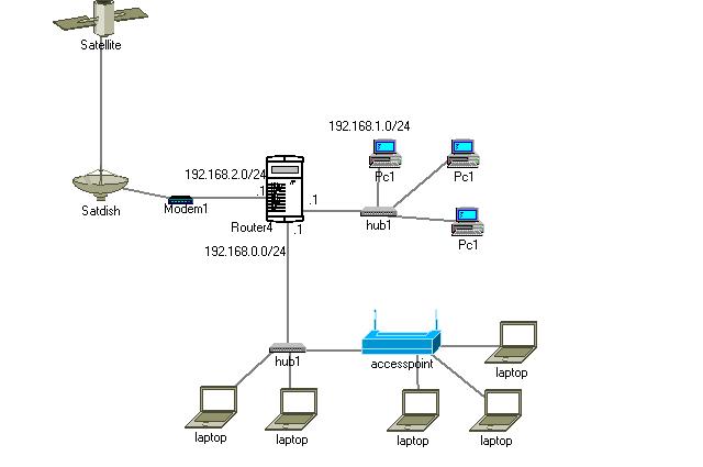

Cannot access the internet using hotspot
My clients doesnt have access to the internet as soon as my hotspot is on
when it is off or when i am using the ip binding everything works well
I have tried everything the only thing i noticed is that people using the hotspot cannot access the internet
Kindly assist

Here in my diagram the internet port is tru Wirelss card initialy was through the ethernet card “xxx”
Here Netwrk 1.0/24 is on hotspot likewise 0.0/24
0.0/24 is not connected yet as i am still tryin to let 1.0/24 work 1st

What I did was to run the hotpot widazrd which automaticaly added dhcp roue andadresses togeda wit the pool as well as dns
After wards I tried browsing the hotspot page pops den login with admin and then try surfing the internet it den dispalys no page found but if I type in an ip adress it goes ( well only tried once )
If I turn off d hotspot it works but wen I put it on back it doesn’t

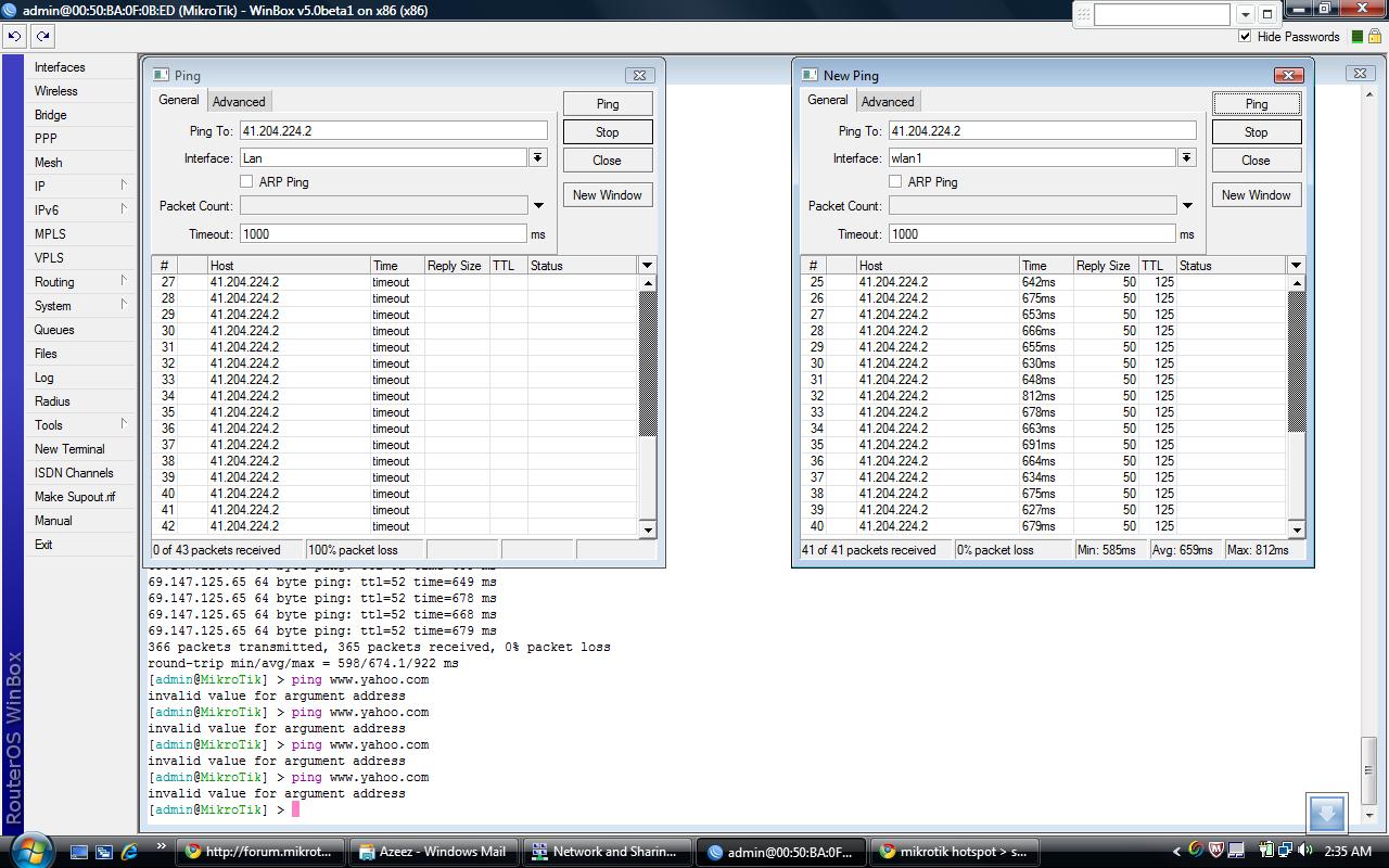

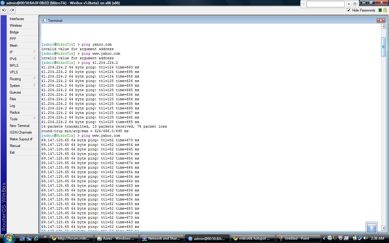

At first it didnt work then i turn off the hotspot and it started workin then later put it on
After like 5 min it stopped again
I pinged my DNS but no reply after that i turned it off again then it worked find below the pictures also note th interface used
Final Picture
