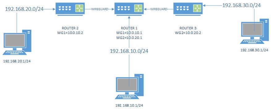

Hello, Hope someone can help me.
I have 3 routers that are connected via wireguard in order to access the internal network of each router.
The problem is that from network 192.168.20.0/24 I cannot access or ping the network 192.168.30.0/24 (vice versa), but from network 192.168.10.0/24 I can access both networks 192.168.20.0/24 and 192.168.30.0/24. I am attaching a picture of my network.
Does anyone know where the problem is?
THANK YOU

Do I have to create a second tunnel to access remote sites between 192.168.20.0/24 ↔ 192.168.30.0/24?
Did you read the info in the link ? Really ?
You might want to read this one, paragraph B:
https://forum.mikrotik.com/viewtopic.php?t=191442
The picture you provided is already fine.
But we don’t see anything regarding the config of your devices.
How is anyone supposed to know then what’s wrong ?
Maybe we should all look together in a crystal ball to see what comes up …
Post your configs please (minus serial, public WAN IP, private keys, …)
And between code quotes thankyouverymuch (much better for readability).
[code] config [/code]
