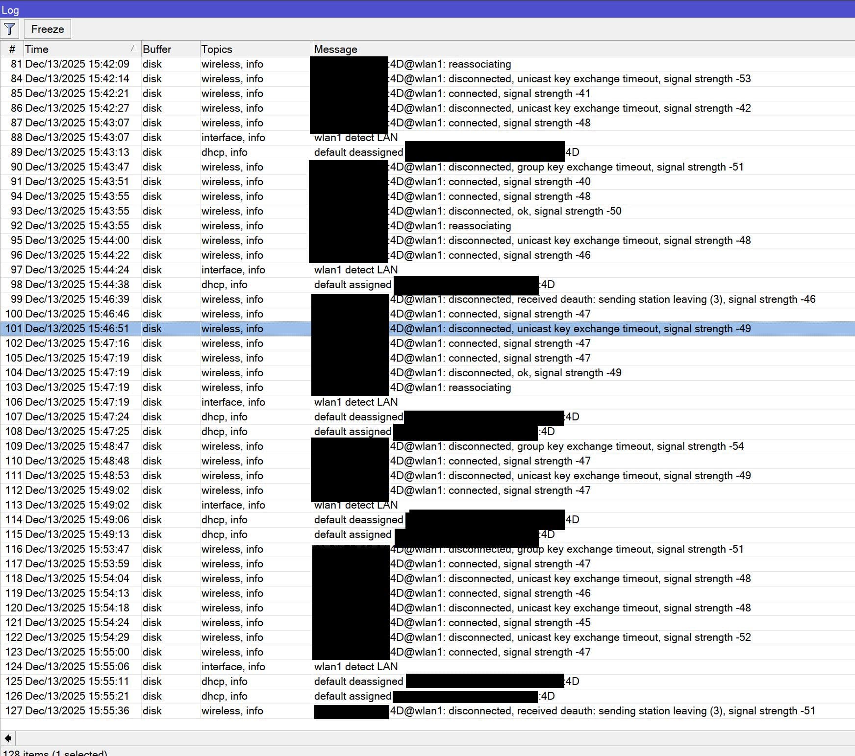

About two weeks ago, I got back from a weekend away, and it seemed that my WiFi-connected devices wouldn't connect. I reset the router, and everything seemed OK.
Then my newest Alexa seemed to fail to connect, so I swapped it out for an old one, and that seemed OK.
Since yesterday, nothing seems to connect via WiFi.
I have rebooted the router, removed power and even rolled back to a September 25 backup, all to no avail.
This is for 2 Alexa’s and my phone, plus one other device.
With the phone, when it detects my network, it refuses to log on due to no internet access. I have internet access on my wired devices and obviously used to on my WiFi. I’m not sure that my phone is detecting the network all the time.
Looking at Quick Set, I see the one Alexa I’m trying to connect pop up briefly occasionally and then just go, once it even got its IP via DHCP. One other WiFi device is missing, though I think it was there for a bit and has now just gone.
Attached is a log the device is one Alexa, I am testing.
