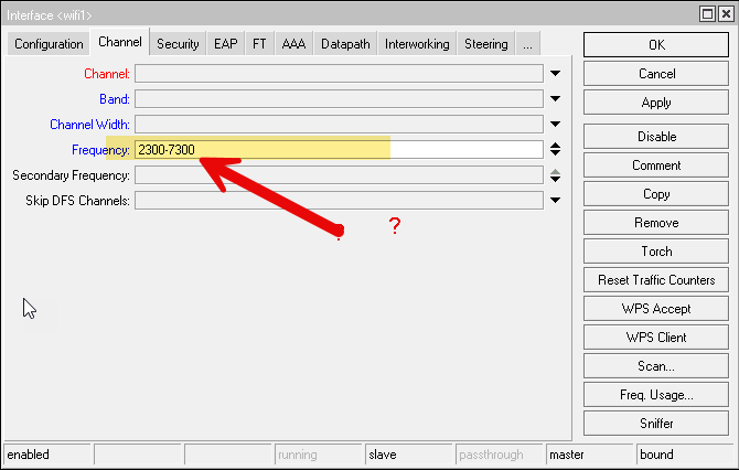

Under “Channel” I get unknown
Yeah that’s your problem. Set that frequency to just 5200, save, and then try to connect with your phone. The wifi will be unavailable for a minute while the radio is restarted.

Channel 40 has frequency 5200 MHz.
Don’t worry it is “normal” :slight_smile: to have these doubts, as soon as you learn about channels, people will make reference to frequencies, and viceversa.
The rationale is that “high” channels (above 144/5720 MHz) have been added as an extension to the original 5GHz ones, a number of (slightly) older devices simply do not “reach” them while more recent (AX) Mikrotik devices tend to prefer these higher channels when set to “auto”, in these cases it is needed to “limit” the Mikrotik to lower channels.
