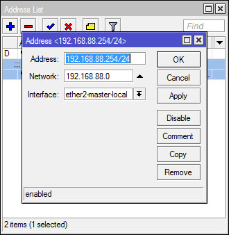

Just have change the IP address to 192.168.88.254 as the screen captured below. Also still cannot access to Internet after change.
Did you change the dhcp server and repair the network connection?
