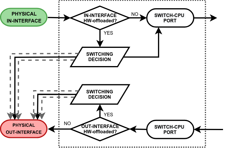

I tried to filter it with a switch rule without success neither. That is even more strange. This should works here because the switch cpu output port is after the software cpu output, according to this diagram. So any filtering here should works regardless the origin of the packet.

The key here is that the switch chip rules are processed at ingress. So you have to link this rule to ports=switch1-cpu to make it filter the frames carrying the MNDP packets on their way from the CPU to the wire. To make it filter only frames that egress via ether3-sw1-ISP-IPv6-INFO, you have to set new-dst-ports to a list of egress ports of the switch on which the MNDP is allowed.

This is the bit I was missing. On the diagram you’ve posted a few posts above, you can see that the “switch decision” is only taken if hardware “offload” is permitted, and I’m afraid that the “switch decision” includes the processing of the switch chip rules. So if the “IPv6-only” uplink port is configured for hw=no on the relevant /interface bridge port row, it is well possible that this is the reason why the switch chip rule is bypassed.
i did see that too, and i tried to enable and disable hardware offload to verify if the switch filter is influenced by this setting.
But that make no difference.
I suspect that the “set new destination ports” action in the switch filter does not work if the source port is the switch CPU. Or perhaps that there is no filter available at all for this direction of traffic.
