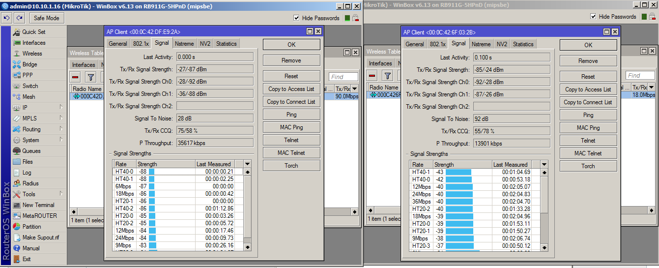

i finally did netinstall and reverted back to version 6.13 its become quiet stable but i found the following strange thing.
both units are just 50 meters apart and still check their signal strength.
Broken wlan card. ![]()
It seems like something is broken also to Your last image. no antenna Connected?
its a SEXTANT hence antennas are there by default.
It can still broke. Its common to burn chip, bad coax etc.
-26???
Put tx power to 1 on both board…
