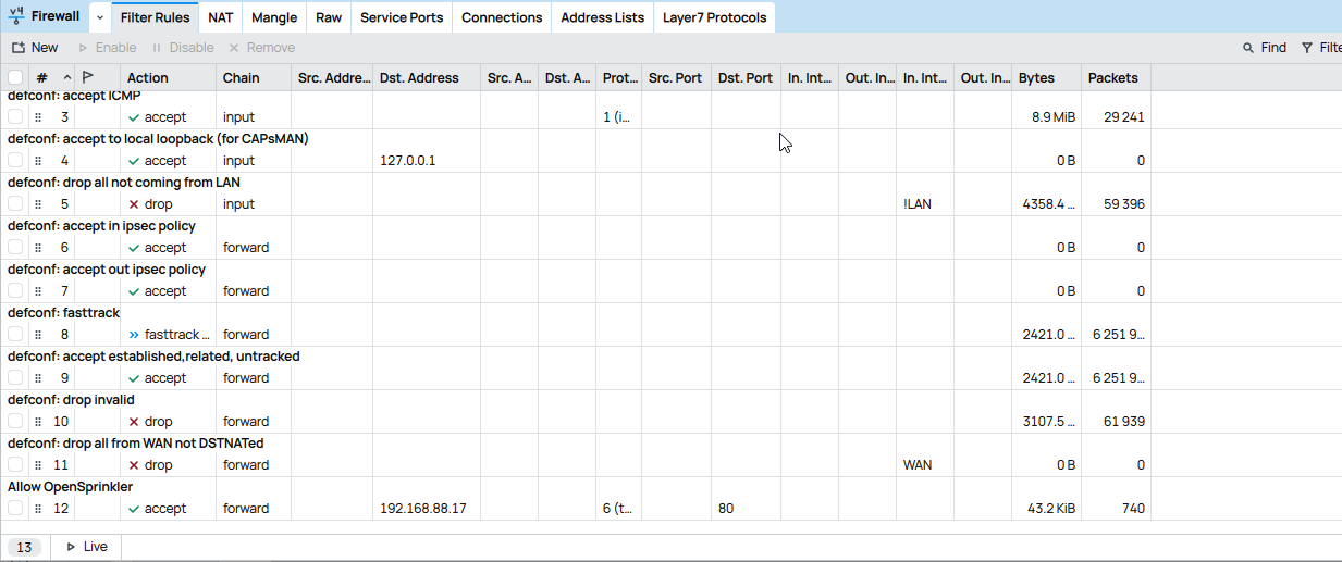

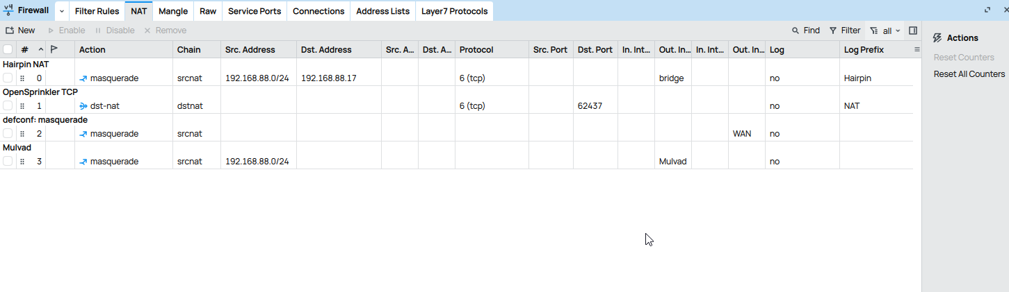

I’ve been reading posts and troubleshooting this for a bit. I have a Sprinkler Controller which needs port forwarding to be accessed outside the network. My configuration works great until I enable Wireguard on the router and then the Hairpin rule never fires. I can access the Sprinkler Controller from within my network or externally if not connected to my local network. However, I am not able to access the Port Forwarding address through my internal network when Wireguard is activated.
The screenshots do not provide enough information, because many columns are by default hidden, and because the cause for your issue is probably in the mangle table, that we can't see.
