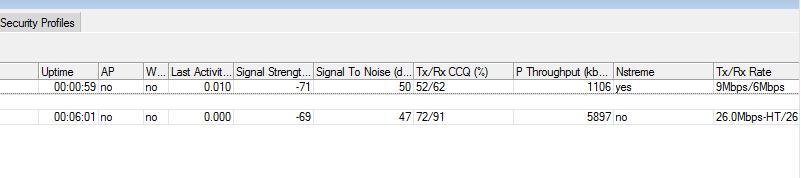

I cannot for the life off me get a particular link to operate properly. Please see attachement
Signal Strength : -71
CCQ : 52/62
P-throughput : 1106
Data Rate : 9mbps
SNR : 50
Nstreme has not effect.
I am using a dual polarised dish connected to 2x radios.
wlan1 channel: 5180 using 802.11a
wlan2 channel: 5320 using 802.11n
Each on a different polarity.
Since both links are not functioning properly, I am thinking that the problem is with the antenna.
Your thoughts?
