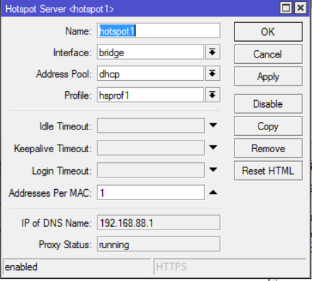

ISP router → hAP Lite (ether1)–> wifi with hotspot.

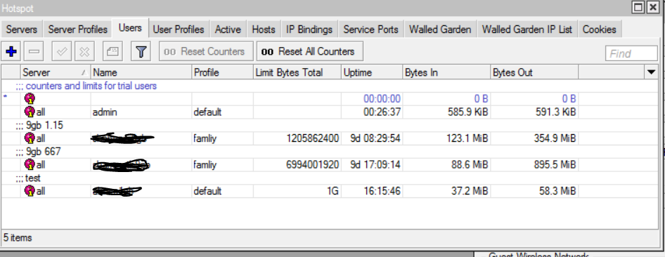

3 users are setup with quota limits then i found users are using above their limit.
internet does not get cut off when set limit is reached.
I think this device does not register correct traffic usage by users.
After user use 10GB on their phone, mikrotik counter reports ~300MiB used.

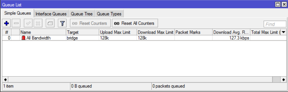

Then i decided to throttle bandwidth and applied simple queue.
When i load the hotspot login page mikrotik shows controlling the bandwidth but after login, internet traffic comes at full speed.
I think same reason with quota problem.

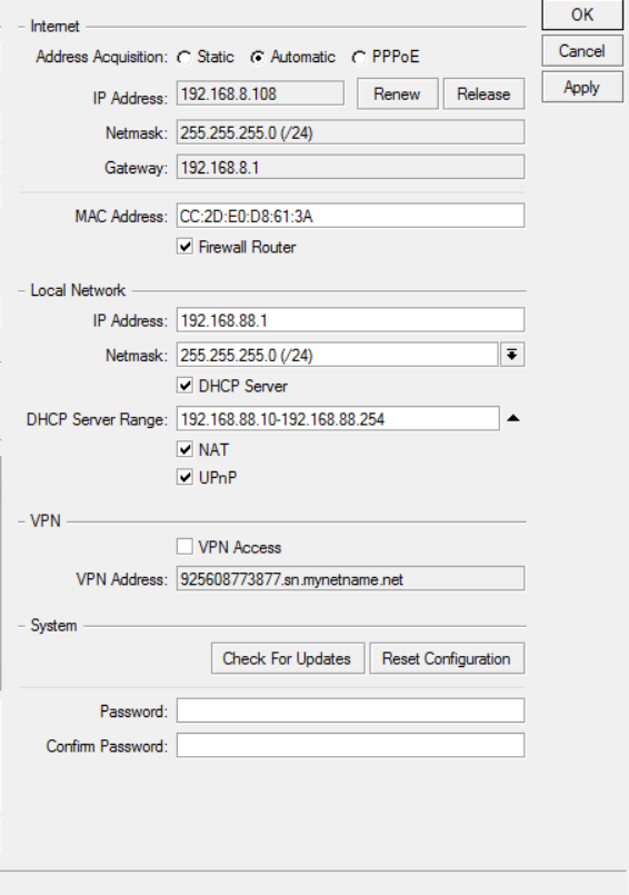

Does the client bypass wan traffic throught mikrotik?
LAN traffic is controlled, wan traffic does not.
I’m sure there must be configuration issue. Any ideas?
