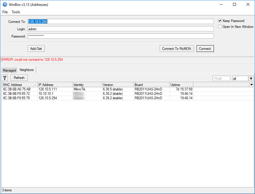

Cannot Login to router by IP, but only by MAC

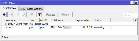

DHCPClient

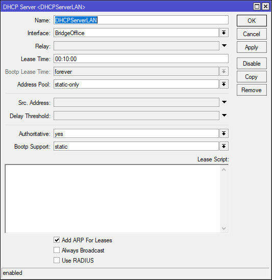

DHCPServer

Sindy, the problem I am facing is that first I had done a hairpin, but that did not allow me to access to the router, but only through the MAC Address, now that I delete that configuration I cannot access with my public Ip address to the cameras or others devices in my LAN.

add address-pool=dhcp_pool1 disabled=no interface=BridgeVlan5 name=
DHCPServerGuest
add add-arp=yes address-pool=PoolFatima disabled=no interface=Fatima name=
ServerDHCP

add comment=“DHCP Client From IPS - Ether WAN” dhcp-options=hostname,clientid
disabled=no interface=ether1

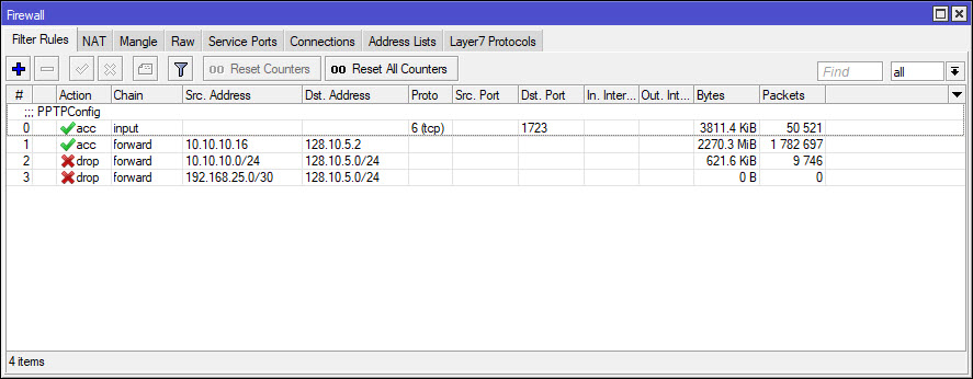

add action=accept chain=input comment=PPTPConfig dst-port=1723 protocol=tcp
add action=accept chain=forward dst-address=128.10.5.2 src-address=10.10.10.16
add action=drop chain=forward dst-address=128.10.5.0/24 src-address=
10.10.10.0/24
192.168.25.0/30

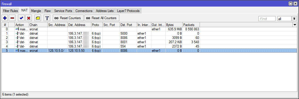

  2. you haven’t added any firewall rule with disabled=yes so it is hard to guess which one causes the conflict. But from the history, I suppose that it is this one:
add action=masquerade chain=srcnat dst-address=128.10.5.50 dst-port=8086 out-interface=ether1 protocol=tcp src-address=128.10.5.0/24
The problem is that I cannot understand why this rule should have any effect at all. It cannot help access cameras’ port 8086 from LAN via the public IP of the 'Tik because in your configuration, out-interface=ether1 is never true simultaneously with dst-address=128.10.5.50 src-address=128.10.5.0/24.
To make the hairpin NAT work, you need to make the cameras think that Mikrotik is the client, so that they would send their responses to Mikrotik rather than directly to the real client. If the real client sends the SYN packet to the WAN address of the Mikrotik but receives the SYN,ACK response from the LAN address of the camera, it doesn’t recognize it as a response to the SYN. So just removing the out-interface=ether1 from the rule should be enough to make the access to cameras work. You could replace it by out-interface=BridgeOffice but it is not necessary as the combination of dst-address and src-address has the same effect.
It would also be cleaner to replace action=masquerade by action=src-nat to-addresses=128.10.5.254 in the rule, but it is not the essence of the trouble.
add action=accept chain=input connection-state=established,related
add action=drop chain=input connection-state=invalid
add action=drop chain=forward dst-address=128.10.5.0/24 src-address=10.10.10.0/24
add action=drop chain=forward dst-address=128.10.5.0/24 src-address=192.168.25.0/30

add action=src-nat chain=srcnat dst-address=128.10.5.50 out-interface=BridgeOffice protocol=tcp
src-address=128.10.5.0/24 to-addresses=128.10.5.254
I could figure it out…and It got like this
[admin@***] > ip firewall nat print detail
0 chain=srcnat action=masquerade out-interface=ether1 log=no log-prefix=“”
1 chain=srcnat action=masquerade protocol=tcp src-address=128.10.5.0/24 dst-address=128.10.5.50
out-interface=BridgeOffice log=no log-prefix=“”
2 chain=dstnat action=dst-nat to-addresses=128.10.5.50 to-ports=8086 protocol=tcp dst-port=8086 log=no
