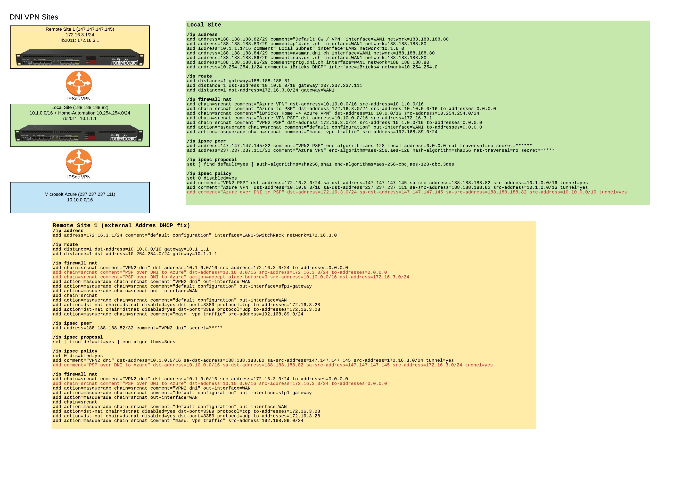

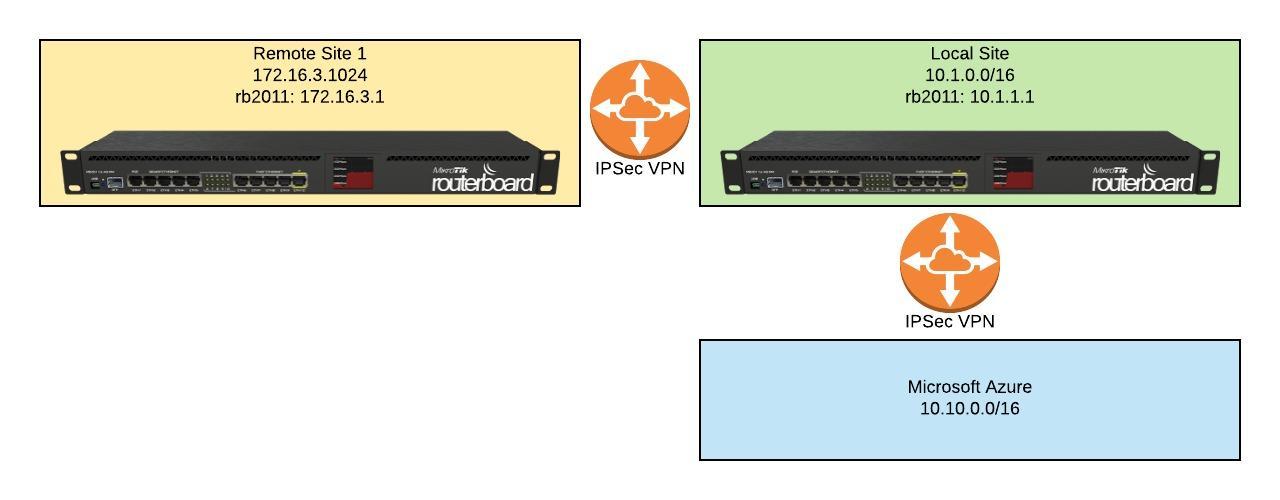

Hi experts
As you can see on the image I have two IPSec tunnels, one to a Remote Site, and onother to Windows Azure.
I Can reach both sites like following matrix (using ping and oher protocols):
Local Site → Remote Site 1 = Ok
Remote Site 1 → Local Site = Ok
Local Site → Azure = Ok
Azure → Local Site = Ok
But I cannot reach the Remote Site from Azure like:
Remote Site 1 → Azure = Nok
Azure → Remote Site 1 = Nok
What roules I have to configure to let the remote sites speaking together?
Thanks in advance
best regards
Damian
hi magchiel
I’m still not able to reach the site.
The actual config is shown above.
Thanks for fourther help
best regards
Damiann

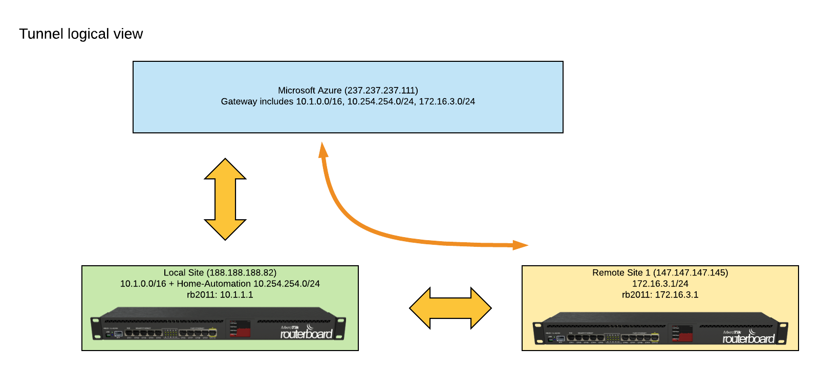

Hmm, this seems to be a challange for me…
first challange: get azure to local site tunnel (237.237.237.111 ↔ 188.188.188.82)
2nd challange: get traffic trough this tunnel to SN 10.1.0.0/16 and second adapter/network on local site (10.254.254.0/24)
3rd challange: include remote site (147.147.147.145) with tunnel between local site to allow trafic from/to azure and from and to local site
any suggestions how to reach that?
Thanks very much
Best regards
Damian
