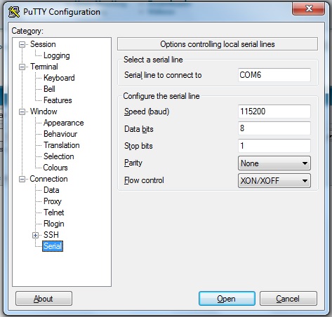

your all settings are ok in putty, just try with Flow Control : XON/XOFF
