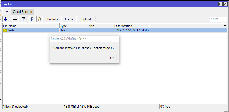

I have the same problem. I once used a netinstall a few months ago and after flashing a different version of RouterOS, it left this flash folder (disk) and I can’t remove it. It takes up all the space - 16MB and I can’t install new certificates due to lack of space.

Normally the root of storage, as accessible via File menu (or /file in CLI), is area on flash storage of router. However, on devices with less than 32MB flash (so devices with 16MBish flash) and equal to or more than 64MB RAM, the root of storage is actually in RAM disk … and the (reminder of) flash storage is available under /flash . So you don’t have to (nor want to) delete that directory.
Now, lack of flash space is nowdays mostly related to too many installed packages … e.g. routeros and wifi-qcom-ac use up almost whole flash storage and if configuration requires anything larger than bare minimum settings, it may push flash storage to the limit. Cetrificates require a few kB of space (each) and that’s not negligible on space-constrained devices.

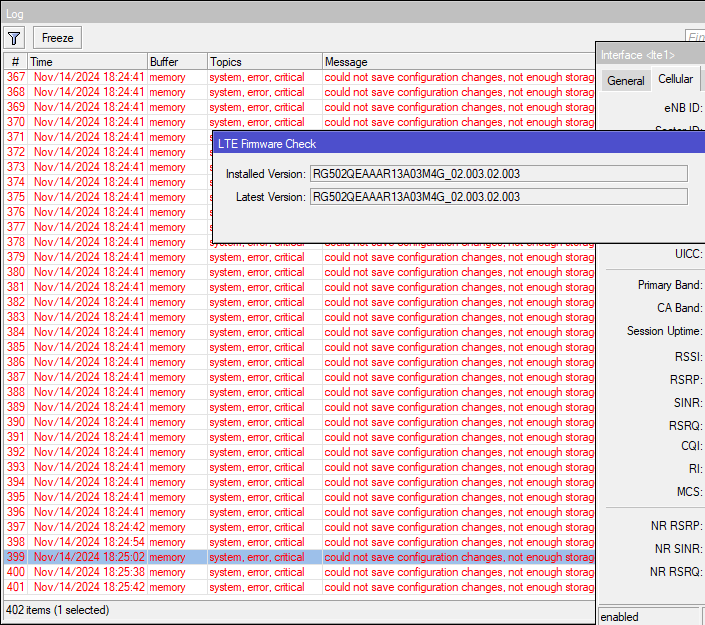

Log gets flooded with these messages whenever I do something, for example, “Check firmware” of LTE interface..

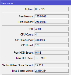

And Resources window:

20:43:33 echo: system,error,critical could not save configuration changes, not enough storage space available.

it seems that in versions 7.17beta/rc there is some kind of problem that is actively consuming memory space
on my ac2, I successfully used 7.16rcX for several months without errors, but after updating to 7.17rc2, less than a day later, dozens of saving errors began to appear
of course, I went to files and saw that 0% of the space was available and 16 out of 16 were occupied, but it was obvious before that
however, it is not at all obvious why this is happening: I almost did not change the configuration and did not upload anything to the files
