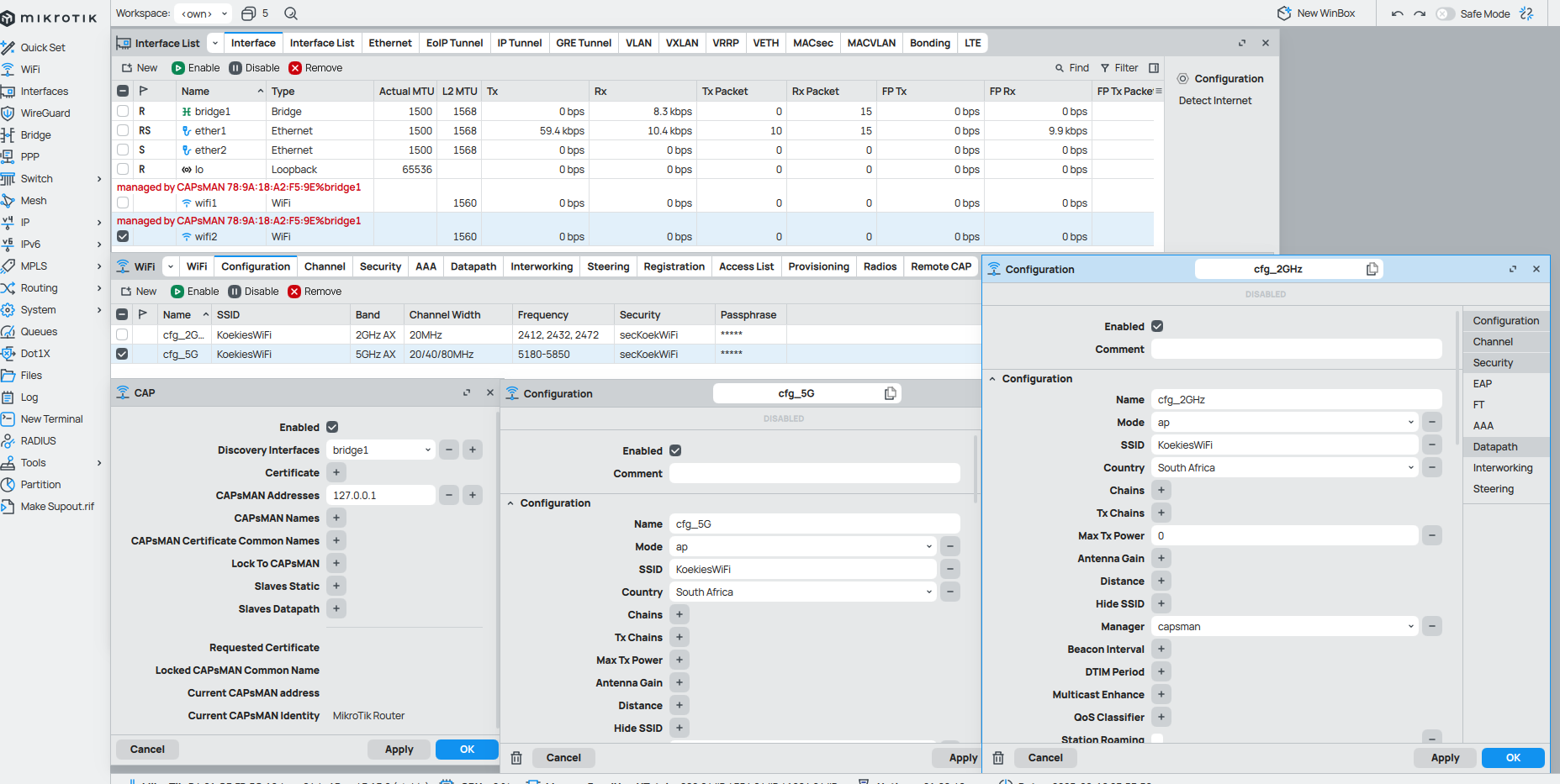

Setting tx-power to 0 is not default, you need to remove it, and you should set CAPsMAN address to 127.0.0.1, the reply by erlinden is correct regarding CAPsMAN managing it’s local interfaces. Aside from that, check what frequency is selected by CAPs, it might be that upper frequency is selected on 5GHz interface that your wireless client might not support, sometimes that’s the case if SSID cannot be seen.
Thanx I see, I by mistake clicked the TX MAX then it add the 0, I have deleted it.
If you look at my first post in the bottom left corner I have set the CAPsMAN Address to 127.0.0.1
I have also expanded the 5GHz range to the default value 2300-7300 but still I do not see the WiFi SSID on any of my devices or laptops. When I disable CAPsMAN I see the SSID
Below is a new script after the changes made

I meant to say “shouldn’t”, or rather you must not set it to 127.0.0.1. See the text quoted earlier.

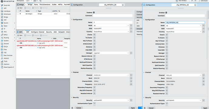

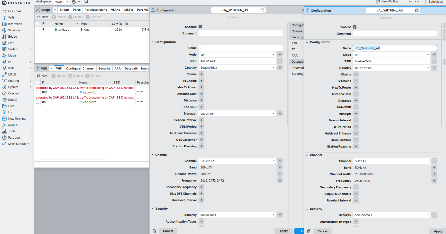

Ok I have made some changes:
1.>> Setup my router (RB5009UPr+S+) to handle the CAPsMAN setting
2.>> Setup the cAP AX to retrieve the CAPsMAN settings from the router
Somewhere I'm making a mistake using the Winbox user interface to setup CAPsMAN as the cAP AX is receiving some CAPsMAN config but not everything. Below are the scripts for the router and cAP AX

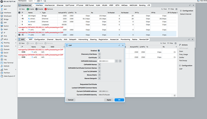

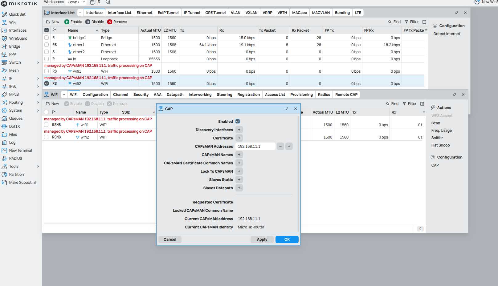

Belwo is the screenshots from the Router and cAP AX:
Router:
cAP AX:
manager=capsman needs to removed from configuration you are passing via CAPsMAN to CAP, and you need to two separate provisioning rules, it would be best to add one rule for each, using supported-bands as a matcher.
/interface wifi provisioning
add action=create-dynamic-enabled disabled=no
What should be provisioned? You are missing the configuration (“master-configuration”) here.
/interface wifi capsman
set enabled=yes interfaces=bridge1 package-path="" require-peer-certificate=\
no upgrade-policy=none
You should disable CAPsMAN on the cAP AX, as it has no purpose.
Thank you, I was setting the provision but as you mentioned no “master” was selected (I did not know that this was required - BIG mistake!!). I selected the master and now everythig is working.
