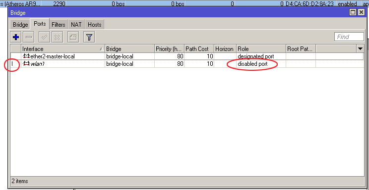

The wlan1 interface shows as “Inactive” and Port Role is “Disabled Port” under the
Bridge-Ports. See attached picture.

Just because nobody’s connected… Connect a client and the interface will be running…

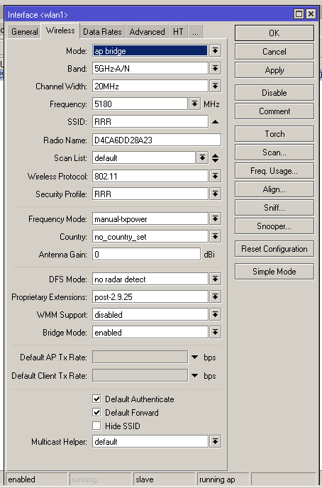

check the Status tab to see on what frequency the interface is running.
Frequency is 5180. I found it in the Wireless Tab
this is a 5ghz ap, you need a 2.4 ghz ap.
This is a 5GHz device. If your devices only support 2GHz, you need a different model. Omnitik doesn’t work in 2GHz
