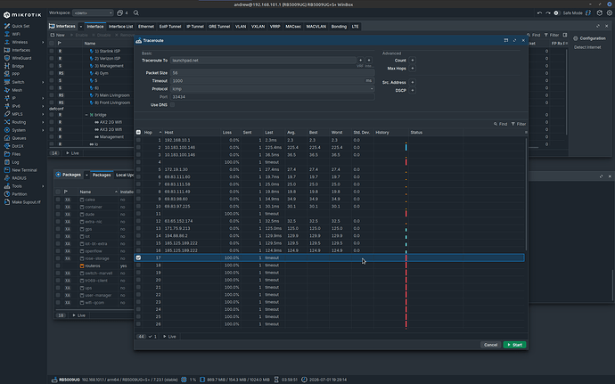

My remote viewing abilities would also point to ipv6. So ping -4, curl -4. Also, if the error is "network unreachable", a traceroute can't hurt.
Don't know what curl -4 is/means. Here's the rest:
This shows broken routing on Canonical's part. They'll probably fix it eventually.

Looks pretty much the same to me, just an extra line for RB5009 and then strange delay between if-bundle... and 66.198.29.175 when the RB5009 is inline. Below order, first two straight on Starlink, second two behind RB5009.

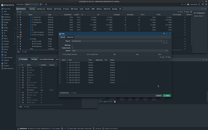

tcpdump shows it's the IPv6 that's failing behind the RB5009:
18:59:03.292477 IP6 _gateway > ThinkPadX1: ICMP6, destination unreachable, unreachable route launchpad-net.ps5-frontend-1.canonical.com, length 88
Don't get this error message on the tcpdump when connecting directly to the Starlink modem.
You can force ipv4 only in the meantime.
echo 'Acquire::ForceIPv4 "true";' | sudo tee /etc/apt/apt.conf.d/99force-ipv4
See if that works.
as i said before, it will be AF (address family) problem ...
your PC will work without problem because dhcpv6 client on linux need to take care only for him self, so PC will req IPv6 address, get one (slaac/stateful) from modem ... and will be happy with that
but .. MT need to grab ia_na or ia_pd from upstream and redistribute this v6 to downstream clients
this way, it will be hard to troubleshoot IPv6 changes on MT

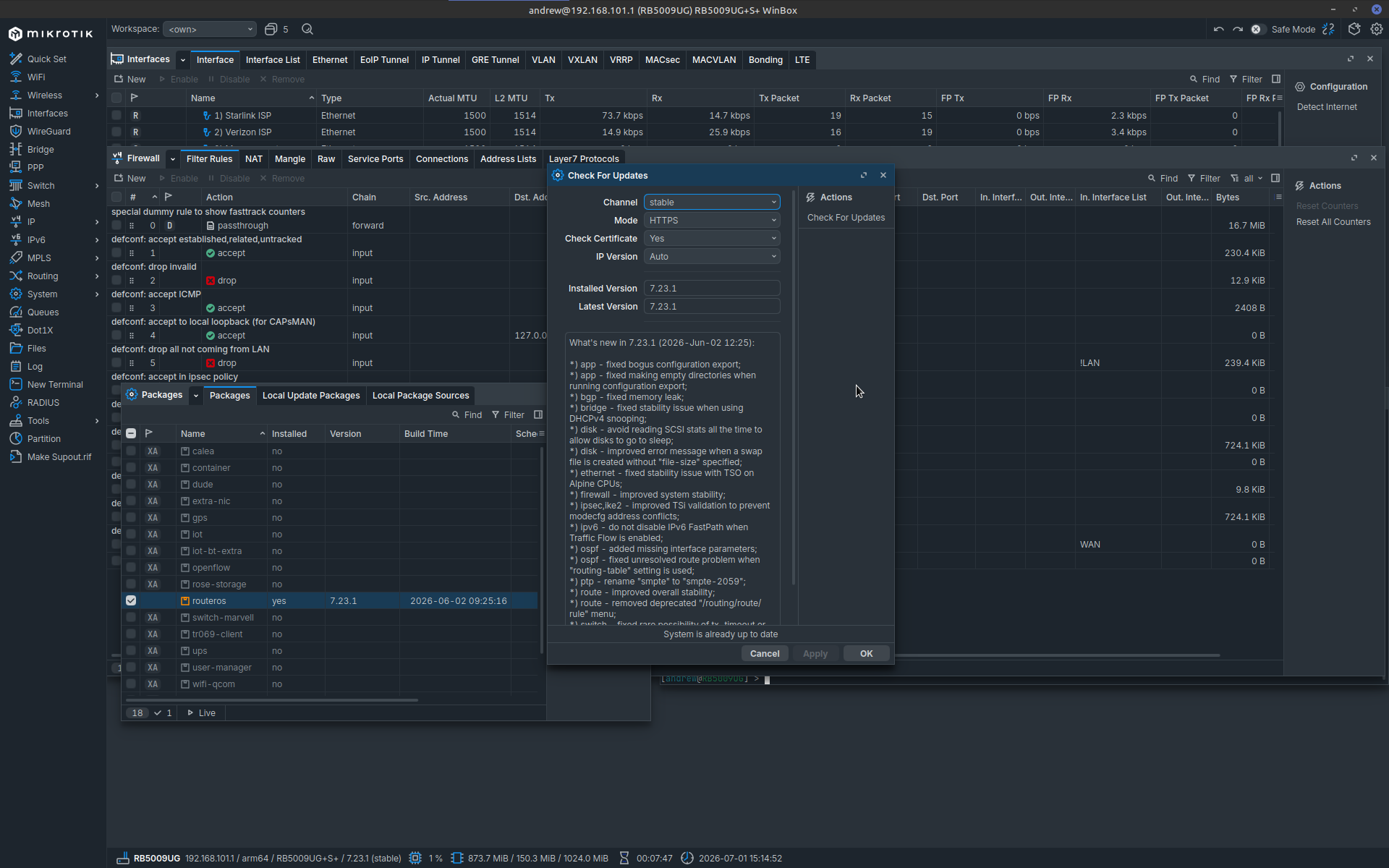

Look, I'm not trying to be difficult but what the heck are you talking about? The attached picture clearly shows my SW level as does Winbox that it was taken from:
What's new in 7.23.1 (2026-Jun-02 12:25):
Why do you keep saying there is no such software?
Ah, no.
Click the pencil on all your posts and change the version
I'm sorry, but why would I change it from what my RB5009 clearly states is installed? What am I missing here?
What's new in 7.23.1 (2026-Jun-02 12:25): ---- This is cut and past directly from Winbox connected to my RB5009. Are you saying my RB5009 is miss identifying what software is actually installed?
Change your posts and topic with the correct version.
