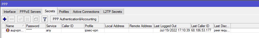

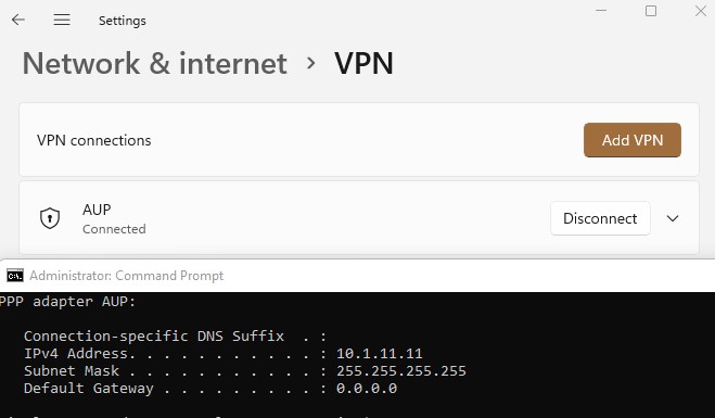

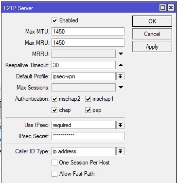

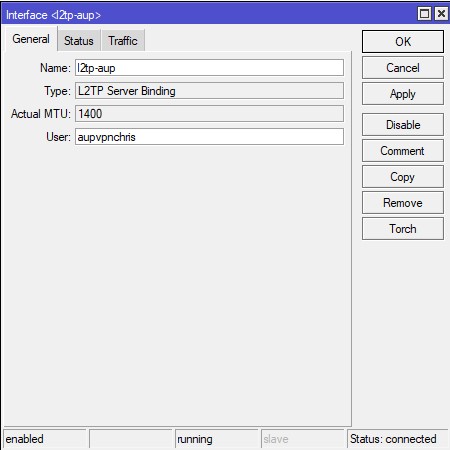

I setup the Mikrotik Routerboard as a ipsec/l2tp VPN server by following a couple blog posts I found online. I can successfully connect to my VPN remotely, but I cannot access any resources on the Mikrotik’s LAN other than the router itself. The Mikrotik IP is 10.1.11.1 and I can access this remotely just fine with Winbox. My vpn connection is assigned an IP from the VPN pool, e.g. 10.1.11.11. Then, for example, I cannot ping a server located at 10.1.11.91. Screen shots attached show my VPN connection and Winbox configuration. Notice that my subnet mask is assigned as 255.255.255.255 with default gateway 0.0.0.0, but why?

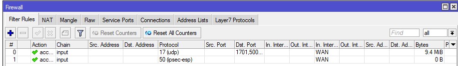

Hopefully you have more firewall rules than just those shown, otherwise the device is open to attack. Depending on what there are you may have to add rules allow traffic from the VPN interface.

The gateway and subnet mask I’m getting from ipconfig on my client seem suspect?
PPP adapter AUP:
   Connection-specific DNS Suffix  . :
   IPv4 Address. . . . . . . . . . . : 10.1.11.11
   Subnet Mask . . . . . . . . . . . : 255.255.255.255
   Default Gateway . . . . . . . . . : 0.0.0.0

There’s nothing to it, you just need proxy ARP as suggested. On client, mask 255.255.255.255 is normal, it gets only single address. Route to remote subnet is Windows “magic” that works with long-dead subnet classes. But you don’t need to worry about that when you have VPN configured as default gateway, which it seems you do, because there’s gateway 0.0.0.0 (it shows like that). So yeah, it should work.
But what I find really really weird, you posted config with non-existent firewall, and it didn’t trigger @anav at all, as if he didn’t see it. Could simple overlapping subnets confuse him so much? :smiley:

@tophermiller: Since @anav is still scared away, I’ll mention it once more myself, you don’t have any firewall, everything is wide open. It’s probably good idea to do something with that. See e.g. this for some inspiration: https://forum.mikrotik.com/viewtopic.php?t=180838
@Sob Thank you and yes, I want to do something about that, but kinda clueless what is required. I’ll read the link you suggested, and also I spoke with the guy who sold me on this mikotik and he recommended the following…what do you think?
add action=accept chain=input comment="accept established,related,untracked" connection-state=established,related,untracked
add action=drop chain=input comment="drop invalid" connection-state=invalid
add action=accept chain=input comment="accept ICMP" protocol=icmp
add action=accept chain=forward comment="accept established,related, untracked" connection-state=established,related,untracked
add action=drop chain=forward comment="drop invalid" connection-state=invalid
add action=accept chain=forward comment="accept in ipsec policy" ipsec-policy=in,ipsec
add action=accept chain=forward comment="accept out ipsec policy" ipsec-policy=out,ipsec
add action=drop chain=forward comment="drop all from WAN not DSTNATed" connection-nat-state=!dstnat in-interface-list=WAN
That’s almost like default config, which looks like this:
add chain=input action=accept connection-state=established,related,untracked comment="defconf: accept established,related,untracked"
add chain=input action=drop connection-state=invalid comment="defconf: drop invalid"
add chain=input action=accept protocol=icmp comment="defconf: accept ICMP"
add chain=input action=accept dst-address=127.0.0.1 comment="defconf: accept to local loopback (for CAPsMAN)"
add chain=input action=drop in-interface-list=!LAN comment="defconf: drop all not coming from LAN"
add chain=forward action=accept ipsec-policy=in,ipsec comment="defconf: accept in ipsec policy"
add chain=forward action=accept ipsec-policy=out,ipsec comment="defconf: accept out ipsec policy"
add chain=forward action=fasttrack-connection connection-state=established,related comment="defconf: fasttrack"
add chain=forward action=accept connection-state=established,related,untracked comment="defconf: accept established,related, untracked"
add chain=forward action=drop connection-state=invalid comment="defconf: drop invalid"
add chain=forward action=drop connection-state=new connection-nat-state=!dstnat in-interface-list=WAN comment="defconf: drop all from WAN not DSTNATed"
Yours is missing the last drop rule in input chain, so it doesn’t prevent connections from internet to router (that’s not good). And default one has fasttrack, which can improve throughput, but also has some side-effects. Both use “block unwanted things and allow the rest”, while the linked thread works with “allow wanted things and block the rest”. I like the latter, but it’s not like the former is wrong, just different way.
