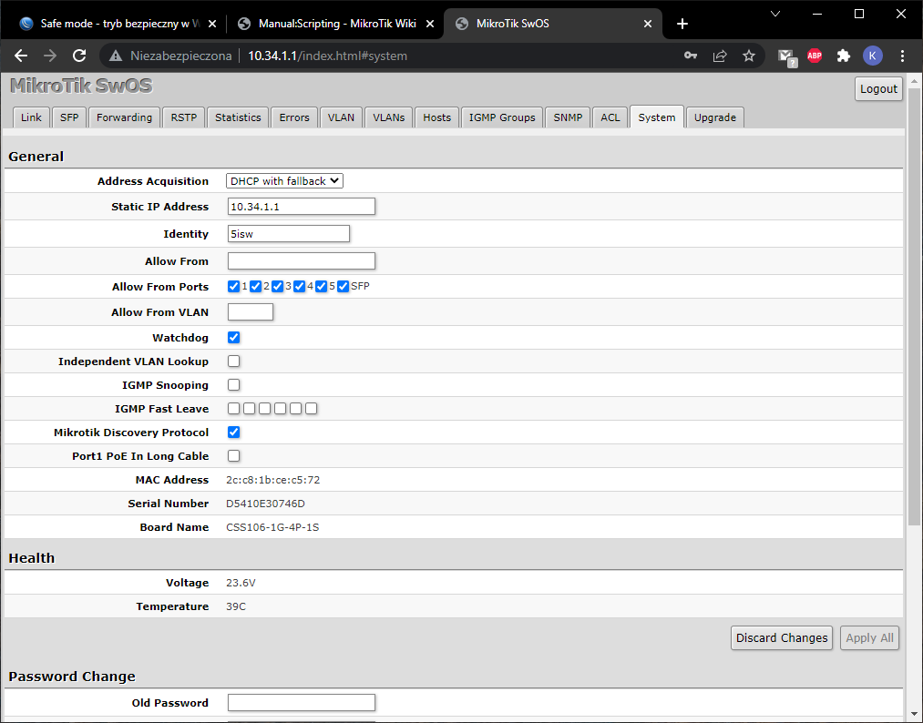

I have same problem with three RB260GSP switches.
Firmware 2.13 (updated today).
They were deployed today with config like attachment. Everything else (not shown on this image) is default.
Each is connected to:
  • 24V 2.5A supply on power jack
  • edge router RB2011 on Port1 (30-70m cat6 cables)
  • 3 mikrotik access points with (3-15m length cat5e cables) on Port2, Port3, Port4
  • 1 IoT device (heat pump wireless to ethernet bridge) on Port5
Everything was fine for 4-5 hours. Now they are all dead from management point of view. They not respond to ping and I can’t access them via HTTP management interface. I have not tried to connect to switches directly, I have to access them via edge router vpn.
Switching functionality works fine at this moment.
What is going on guys?
Are you sure they still have the same IP address? Address acquisition method “DHCP with fallback” is IMO dangerous, it means primary means of address acquisition is via DHCP and any DHCP change can mean change in management IP address change.

Primary address acquisition method is DHCP, because edge router has static DHCP server entry for this switch. Fallback is just in case when edge router is not working.
Yes.
It is just fallback address and it is the same as DHCP static entries for these switches at this moment.
DHCP server status on this entry is in “waiting” state.
Switch also does not appear in mac-scan list when I try to search from routers at Port1 and Port2.
