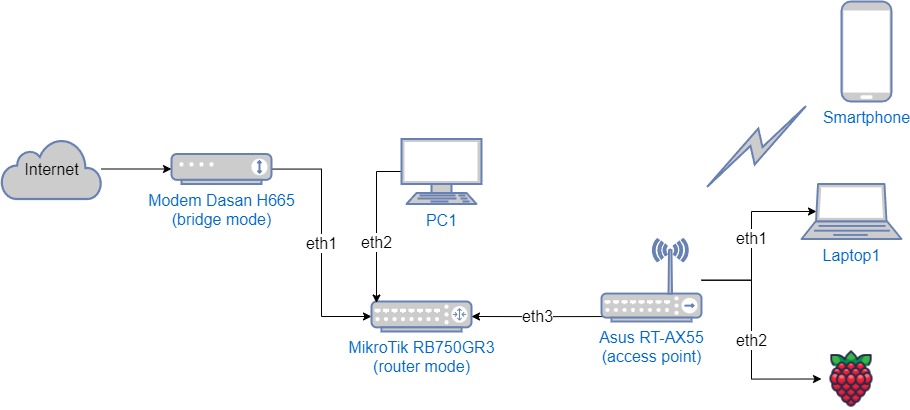

My topology looks like (it’s only a draft, needed for explanation issue I’m facing with):
The problem is with the devices directly connected to the Asus RT-AX55 over the LAN, especially my laptop. All devices connected via WiFi with AP are working as expected.
Except the laptop, I have the RPi connected on LAN port also (it has an access to the Internet, but can’t ping my laptop on LAN IP address or WiFi either).
Yesterday, I spent a lot of hours looking for similar situation to mine, but no luck. Of course, found some of them, but the topology was different.
What I also noticed - when I’m changing a port in the Asus AP to another one it starts working, but for a while only - after 5 seconds or less, it stops.
Yesterday, by end of the day I swapped places the cables between RPI and my laptop and it worked much longer than above. Happy, I went to sleep and today is the same.
I don’t have any ideas how to fix it, but I hope you have.

So the problm is with ASUS. Connect RPi & Laptop to mikrotik and check if they work. If yes then eliminate problem in ASUS. Reset it, upgrade … set to bridge mode if it is possible.
Configuration of most consumer gadgets is not as flexible as configuration of ROS devices. Some features are hard-coded and can not be changed (at least not easily). For example: on most router/AP combos, ether1 is hard wired as WAN interface and that can not be changed. If such device is used as simple AP, then ether1 can not be used (it’s best to tape it off not to try to use such port incidentally).
So, as @BartoszP wrote: check configuration on Asus, focusing on possibility to configure ether1 as LAN port. If this option is not presented very clearly, then assume it can’t be done.
Sorry, I didn’t mentioned that before - that ASUS device has 1 WAN port (it remains unplugged) + 4 LAN ports.
I’ve upgraded the firmware on it to the newest version, but it still doesn’t resolve my issue.
I can’t understand why connection to the Internet is cut off after a few seconds (Windows is pointing that the cable is plugged and I have Internet access).
It’s repeatable - if I put the cable in eth1, it works for 2-3 seconds (ping, www, etc.) and cuts the net off, then I take it out and put it in eth2 it works for next 2-3 seconds and stops..
@BartoszP: I tried to connect laptop directly with mikrotik and it works, but I need that AP to connect the other wireless devices.
