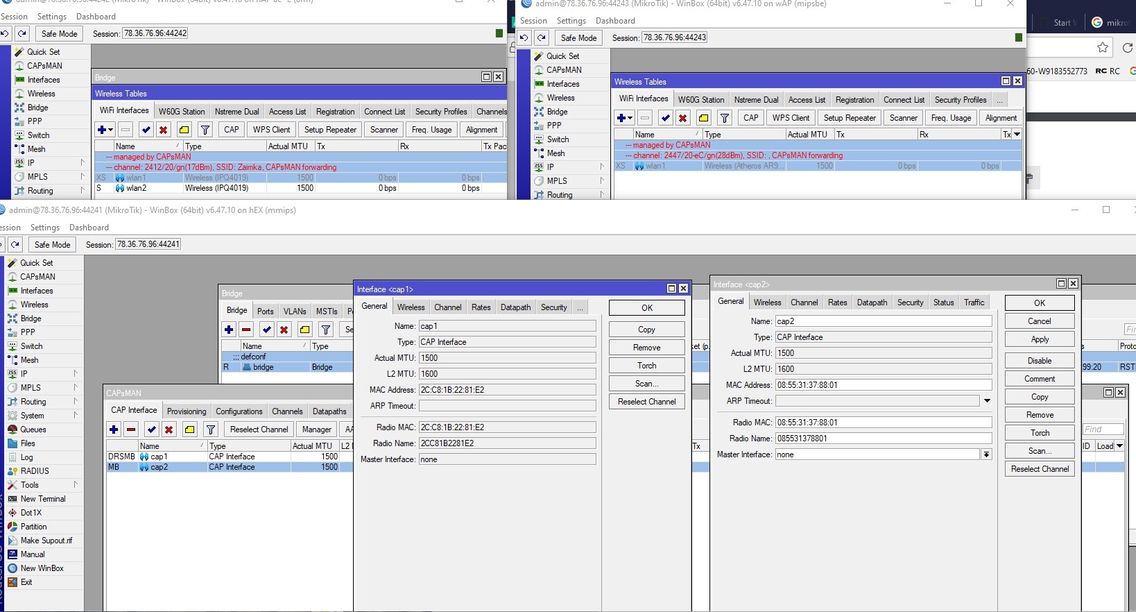

Can't add the second ap to capsman
Hi friends, I've almost tried everything on my knowledge, the second AP stil on MB status, the parameters are the same for the first AP but it doesn't run. It connects to capman but not possibile to connect to that AP. There is the master CapsMAN .88.1, the first AP .88.2 and the second AP .88.3
Here is the photo,and the config of CapsMAN: thank you for precious help,

I've checked the video, nothing new for me there, my problem is more deep than standard configuration, I mean I don't know why the second ap is not getting the proper config from capsman, in the RemoteCAP I see the IP address of the second ap instead of the MAC, as I see for the ap1.
I guess the problem is on bridge MAC of ap2, which is the same of WiFi, strange, on ap1 is different (by default), so I would cahnge it but I can't when it's running, and these caps are 3 hours by car from me, I need to be careful. I've tried to cange the WiFi interface MAC and provisioning the capsman to it, but it's not working, it still use the previous MAC which is the bridge one, the caps is forcing wifi interface to use the previous mac.. which is the bridge too. What is wrong here? I post the capsman config and ap2, thank you for help
Capsman:

I suppose I need to force the bridge using another MAC, but how? Maybe by terminal? Is it safe to do?
PS: I’ve also created the role in ap2 firewall to accept udp packets from capsman (and put the role on position1) as well on capsman to enable receive udp from ap2, no effect
PS2: on ap2 I have “CAP sent max keepalives without response”
PS3: as I read in a forum, I’ve removed the intervace wlan1 from the bridge (just eth1 is present now), as well I did it in the caps config. No effect. ON capsman I still see a MB, the wlan on ap2 still show connected to capsman but no SSID (as well as before)

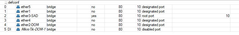

PS4: on the capsman I’ve a strange behaviour for eth3, where the caps2 is connected, what is this root? May it influence the issue? I can’t change it
Now I have the Bridge with the same MAC of ethernet, I suppose that the capsman replies to ethernet MAC and the ap2 cap isn’t receiving the expected packets. Sincerely I can’t figure out why in the beginning it connects, but after doesn’t work. Also paramentes like SSID, fequency etc aren’t passed to ap2 that shows differnet values.
I can’t change MAC of ethernet as well as mac for bridge, but I would like to, how can I do it without loose the router? Thank you!
PS: on capsman I have this:
removing stale connection [08:55:31:37:88:00/10/4d36,Run,[08:55:31:37:88:00]] because of ident conflict with [08:55:31:37:88:00/10/349e,Join,[08:55:31:37:88:00]]
I solved removing the ap2 entry in the “CAP Interface”, disabling and renabling Capsman I’ve seen on both caps a DSMB. By the time I did several canges, like disabling all drops on firewall, remove wlan from bridge, and many more changes.
I consider this a bug of Mikrotik FW, since the CAP Interface is an automatic list appearing after provisioning and enabling caps, it’s not supposed we remove the bad entry to get finally a sucessful one. Please consider this, I’ve spent at leat 6 hours to figure it out.
