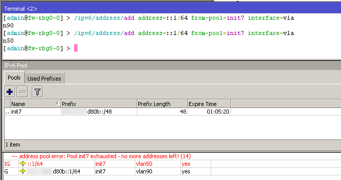

Running RouterOS 7.1rc4 on a CCR1009-8G-1S-1S+. I set up a DHCP Client to request a /48 Pool from my Provider. Now I want to provide a /64 from this Pool to two VLAN’s. But the system tells me that the Pool is exhausted after the first /64 assignement. Did I do something wrong?
set prefix length of the pool to 64

/ipv6 pool
add name=myPool prefix=2001:db8::/48 prefix-length=64
Thanks @hzdrro @netravnen, this was the issue! It now works.
