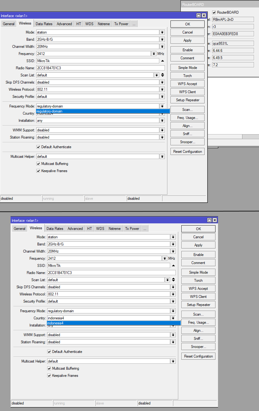

Hi, I have brand new mAP Lite (RBmAPL-2nD). In wlan1 advanced mode, I can’t change Frequency Mode and Country. Are the frequency mode and country set of this device is locked?

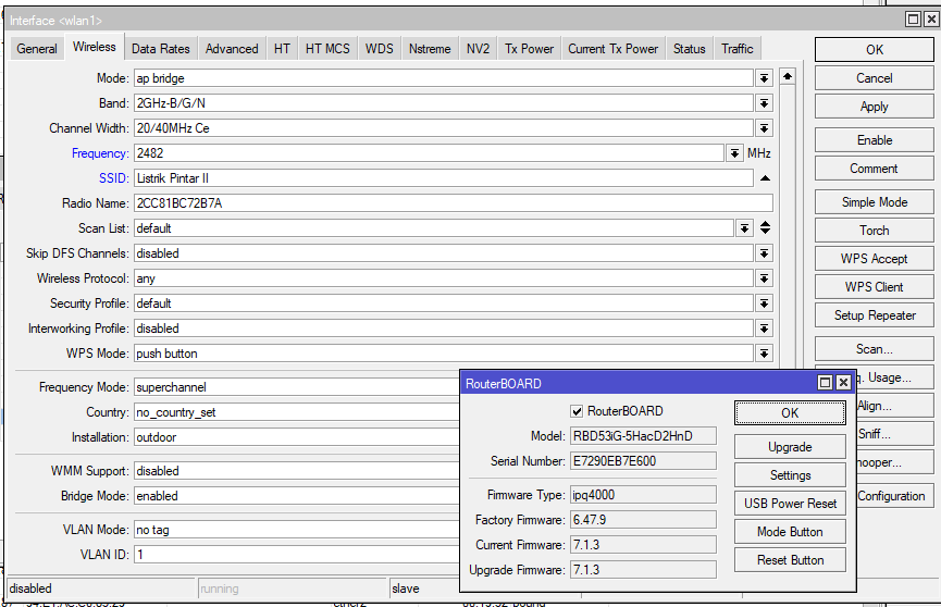

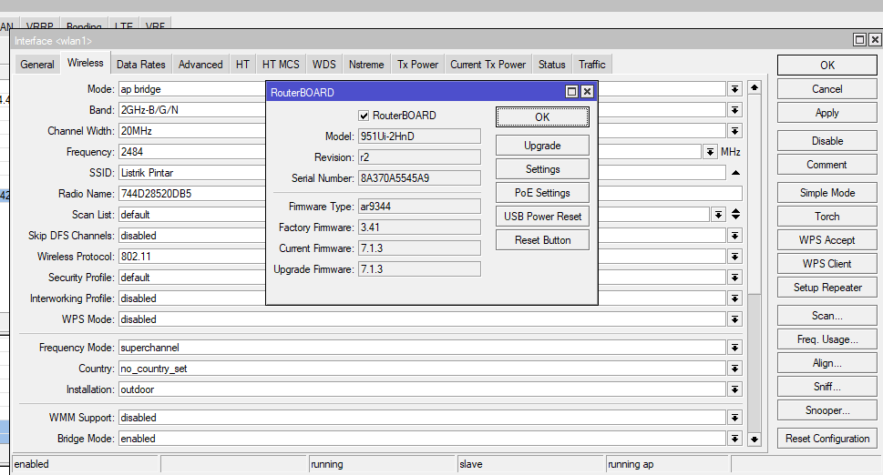

Because I also have another mikrotik router (hAP AC^3 and 951Ui-2HnD), where the wifi frequency mode and country can be set to another options. The IoT device I have requires channel 14 on 2.4 Ghz wifi. Because other channels are already too crowded in my area. How I can change wlan1 frequency mode to superchannel and country to no_country_set for this device ?

It depends on the seller. They might block it, if they only have the right to distribute this unit in one country. You should contact the seller / shop and ask about it.
Adding:
In most counties it can be illegal to use wrong settings on your device.
Best to stick with what is allowed for the location where the device is being used.
The problem can aslo appear if bouyed by Amazon, Ebay or similar from person that sell the device from another country, with own country lock set…
Thank you, I will try to contact the distributor. But I want to ask one more thing, is the wifi frequency range on this mikrotik locked at the firmware level or by hardware design?
both on selected devices
it can be different locks, so better ask the seller. some devices can be unlocked, some - not
I have asked the distributor. They said: “had to comply with local regulations, however, it can still be unlocked with netinstall”. So this problem is solved now.
