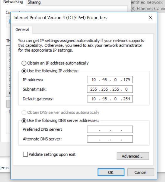

My computer is:
IP: 10.45.0.179
Subnet: 255.255.255.0
GW: 10.45.0.254

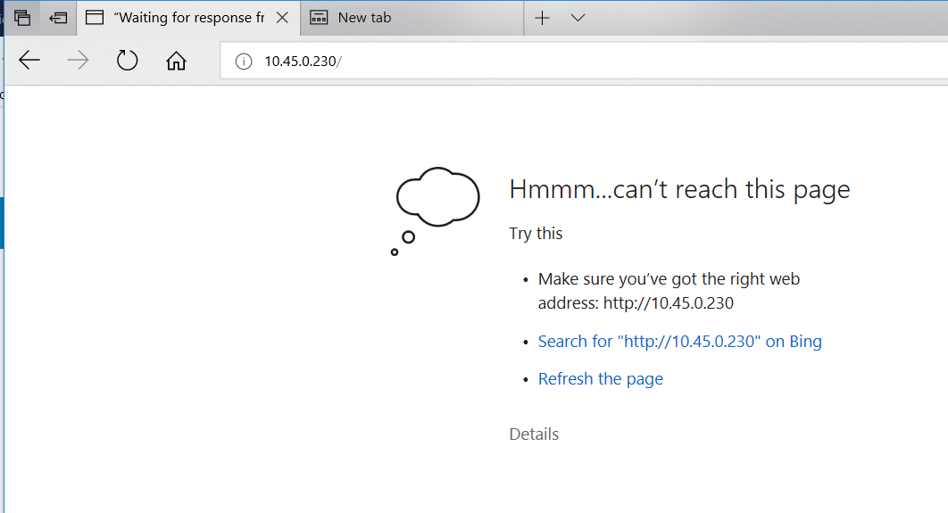

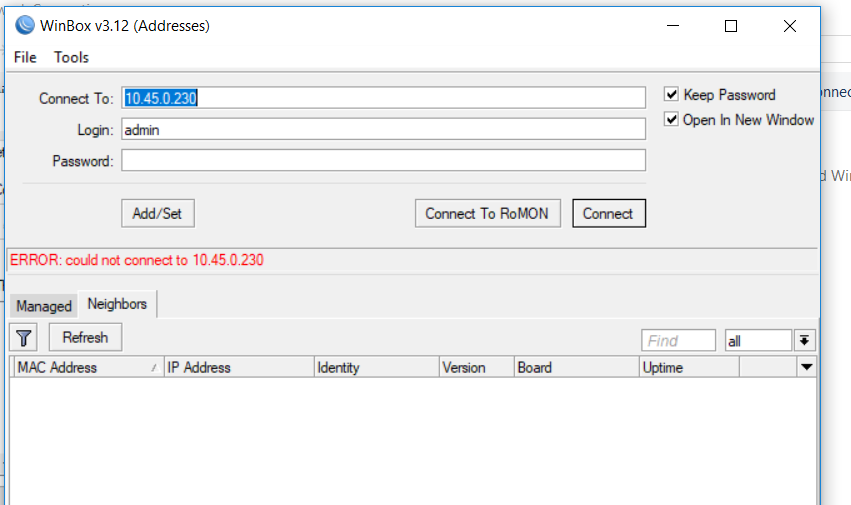

After changing it I can ping it fine but cant log in through winbox, telnet, or webfig. I’ve attached pictures showing what i’m trying.

So, then it’s security issue :slight_smile: Check IP - Services and System - Users. Check IP’s from which your Tik can be available.
The admin user has nothing in the allowed fields but when I changed it to my computers IP address, I still couldnt connect. Does it need something in that field?
What new IP is and on what interface do you change it? Don’t use quick set, use just winbox, in which you can see every settings.
