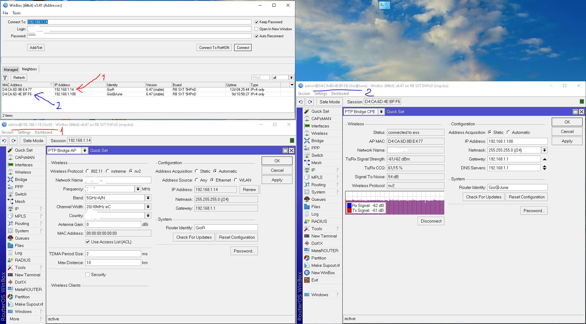

I hope the picure will help.
I connected via WinBox from the AP-side to the AP through IP-Address and to the client through MAC address!
It is not possible to connect to the AP through MAC address and it is not possible to connect to the client through the IP address! wierd! …or not?
(see picture)
if there is somthing in the picture I have to hide, please let me know to change the picture!
Many thanx in advance!
Screenshots are (mostly) useless, you can remove it as well. Open terminal window and execute /export file=aynnameyouwish … fetch resulting file to your management computer, open it with your favourite text editor, redact any sensitive information (such as serial number, public IP address, wireless PSK, etc.) and copy-paste it inside [__code] [/code] tag pair ( icon in the button bar above post editing frame).

Unfortunately I am from the client’s side now and on a MAC using WInBox via Vine. I did it for the 1st time. (Vine, etc.)
The connection to the client’s menu interface, is still not possible via Mikrotik App (MAC&IP), via IP entering in the browser, via WinBox via Vine.
Although the Link is working properly!

*add action=drop chain=input in-interface-list=!2000014
I disabled this ( add action=drop chain=input in-interface-list=!*2000014 )
→ and I can now connect from my MikroTik App to both via IP and only to one of them (xxx.108) via MAC.
→ and to both of them via IP from a regular Browser
…but was this maybe set for more security ???

Update!
From my clients side I am still not possible to connect the client Except only to my AP but I figure out that I was confused where is what.
So, Ι downloaded the RBSXT (I mean I taked it down from the mast) from the side I thought it was the client but I saw that this RBSXT was set as the Bridge AP!
So it also works the other way around.
(Place One with internet connection )- RBSXT (Client) ~~~~~ RBSXT (AP) -(Place Two)
I know it is a little confusing, but the primary connection (the p2p-link) was established when the internet connection was on Place Two.
