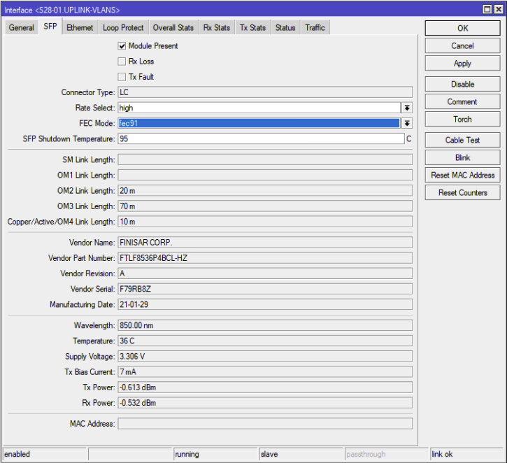

try different fec modes, had to set mine to fec91 to get it working using 25G. (Interface → SFP Tab → FEC Mode).
CCR2004-1G-12S+2XS running ROS7.4.1
