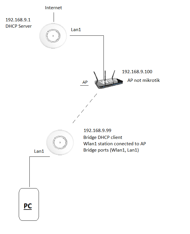

I want built that network. View picture
Devices are RBcAPGi-5acD2nD. But its for labrotory testing only.
Main problem is, PC cant get address from dhcp server. In DHCP server statuss is offered
Is any idea where is my mistake?

The 802.11 WiFi standards do not support transparent layer 2 / ethernet bridging which can break protocols such as DHCP. Various vendors use the 802.11 four address frame packet format / WDS to implement transparent bridging, but as there is no standard method interoperability between vendors is hit-and-miss.
Mikrotik support various client / station modes, see https://wiki.mikrotik.com/wiki/Manual:Wireless_Station_Modes - if you have a single wired device attached to a station connected to a third-party AP then station-pseudobridge may work.
