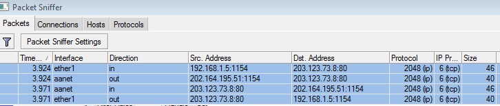

I also sniffed the packets of a web request can anyone tell me if they look correct or not. I have attached an image of the packet sniff.
It could be an MTU issue (which is usually the case when things seem to work except for websites, especially https websites), but that shouldn’t change between the two VMs.
Since your telnet test seemed to work from the router, but not the PC, it sounds like its either not NATting correctly, or not routing correctly, or the MTU problem is on the ethernet side of the router.
From that packet sniff snippet though everything seems ok (I forget what causes the 6 byte discrepancy but I think its normal, I think its recording extra information on inbound that it doesn’t need to record for outbound).
Probably need to see more of the sniff to see what it looks like when the packets are large.
xxii there was not much more in that packet sniff log part from traffic from winbox to manage the router. I will try again tonight when i get home to get more info. I have been playing with the MTU but so far that has not helped and when ever i changed the MTU on the Ethernet side things broke. I also noticed that while the MRU is set on the ppoe connection the actual one shown on the status screen is larger than the one set on the ppoe config screen but not sure what that means.

I’ve been trying to approach this from what could be different between your VMs, and unless there is a difference between the VMs handling of ethernet somehow, I don’t see how it could be MTU.
So on the packet sniff, are there any large packets, and which side was the first to not reply? Were there only those 4 packets in your screenshot?, otherwise, Did any packets come in the ethernet and not go out aanet or vs versa? (basically, as you mentioned, we’re trying to see if packets were dropped somewhere). If you browse to the routeros VM itself, does it come up (I mean the routeros running in the VM. routeros has a web interface.) If you lower the MTU on whatever you’re browsing from to 1480 or less, and try to browse what happens?
