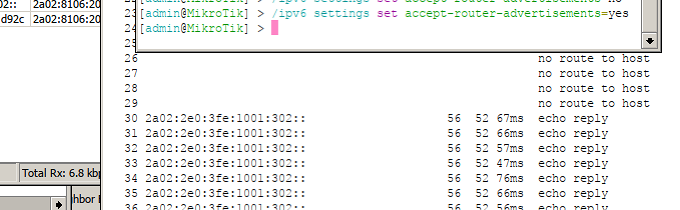

Hey, thx for the hint. I’m wondering how to do that. I already just requested an address in the dhcp client config.
I guess this is the hint I needed:
As soon I enabled router advertisements I’m able to ping IPv6 addresses.
As you mentioned the support in RouterOS is very bad, you don’t see the IP anywhere.
