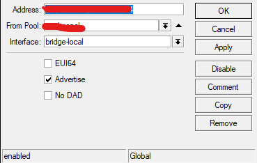

The IPv6 address is with the flag Advertise on.

You may want to edit your screenshot, you forgot to erase the IPv6 address in the title bar.
