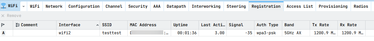

I applied your last config snippet and first thing I see, is waiting for DFS (1 minute).
After 1 minute, SSID testtest showed up in wifi analyzer on my laptop as CH64.
I could connect to it without any problem.
That was however using 7.23rc3 (it was a bit behind and I haven't touched it anymore since that drop).
Applied 7.24rc3, reboot and ... same.
It simply shows up and I can connect to it.

FWIW also connected to it with a Samsung S25.
My ISP connection is 1000/100 (or about), I got 565/98 using Speedtest (with CPU on AX S inching real close to 100% on that download).
So config is definitely not the base problem.
