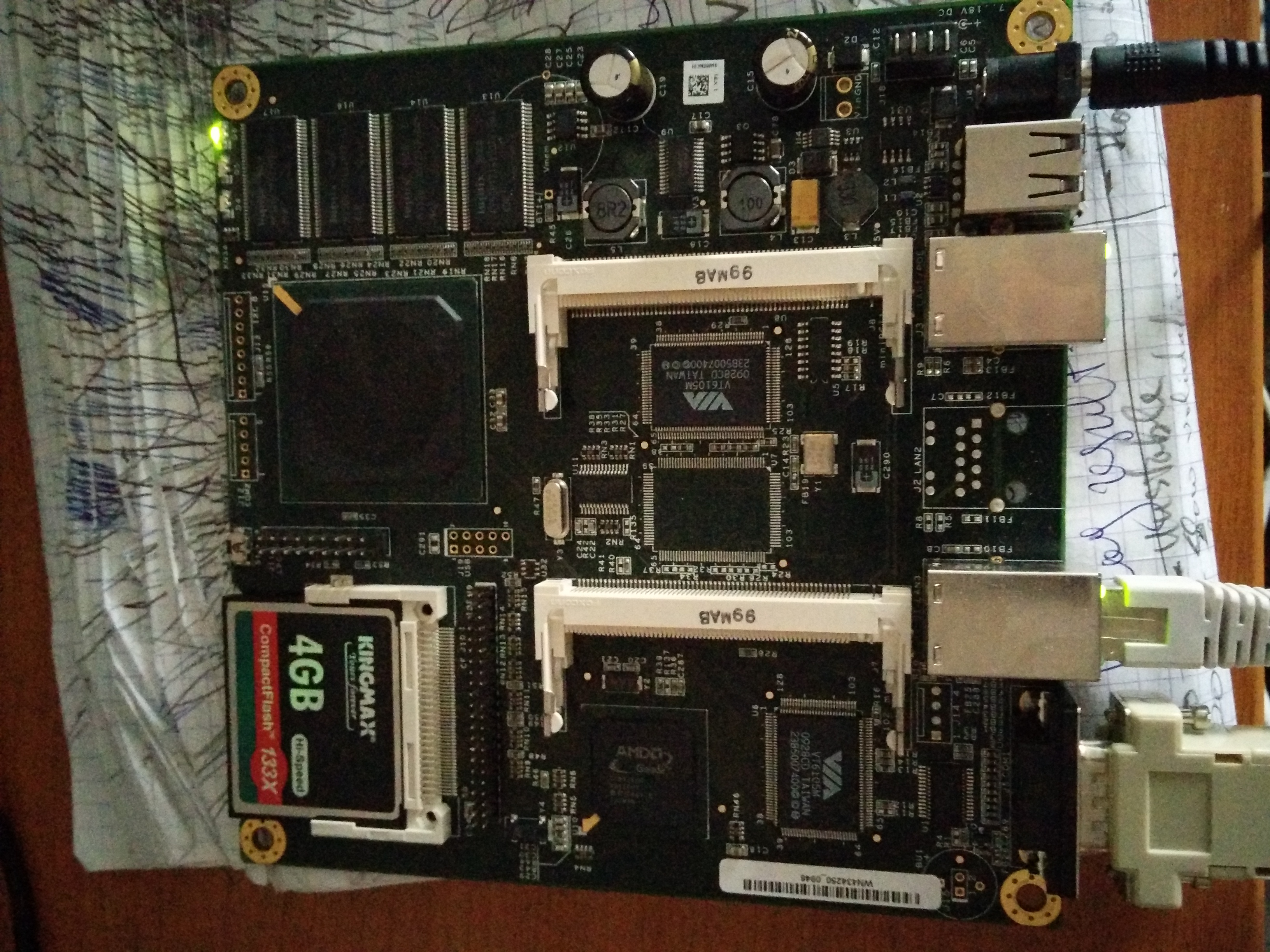

The assembled board looks like this :

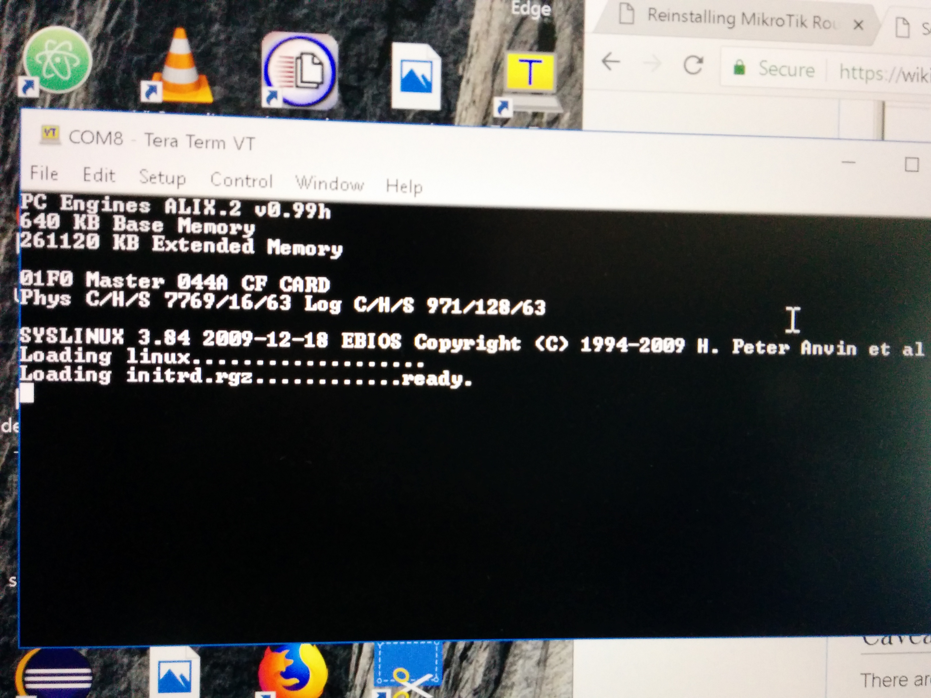

Next, I power it on and I see the following data on the Console window :
and It hangs
Also I've tried to access the board using IP address 10.10.10.211 with no luck. Winbox does not see the board as well.
Can someone help me : How to boot RouterOS on Alix board ? What am I doing wrong ?
