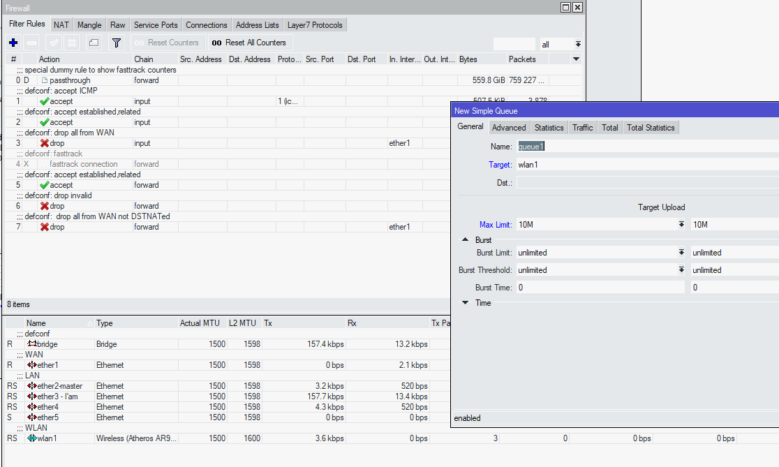

Turned off fasttrack, bridge queue work perfectly, but I need to limit only wlan, which is not work, I guess I need to add some firewall rules, can some one help me?
2017-09-05 08-16-51 admin@192.168.88.1 (MAIN_RB951G-2HnD) - WinBox v6.39.1 on RB951G-2HnD (mipsbe).png
Look at the “Traffic” tab. Do you see any traffic on this rule?
Try and make your target the bridge interface
