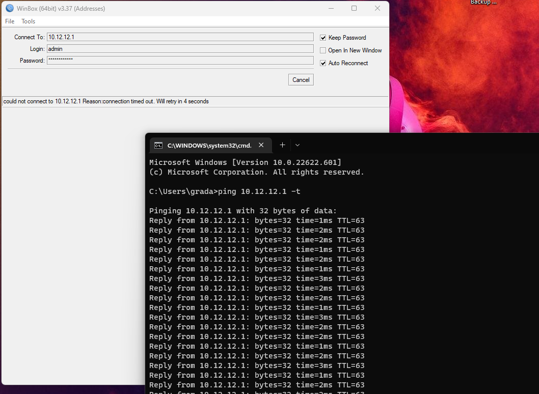

Can't login by IP to LHG LTE18
Why this can happen ? It pings, it works with main router, it gives internet, but i can connect to it only directrly with lan cable.
Config is almost default, just maked bridge with only one erher1 port, added ip address (10.12.12.1), and turned on DHCP server with pool 10.12.12.100-10.12.12.200 for bridge (ether1)… that’s all

As for not logging in, good chances there is a misconfig in IP settings between device and PC. Or you have mis-configured/disabled access to the router from the interface your on.
See if you can use MAC logon instead ( MAC addr of the physical and or bridge mac )
https://wiki.mikrotik.com/wiki/Manual:Winbox
they are in different vlans, but my vlan have access to all, and some other mikrotiks connects by ip..
