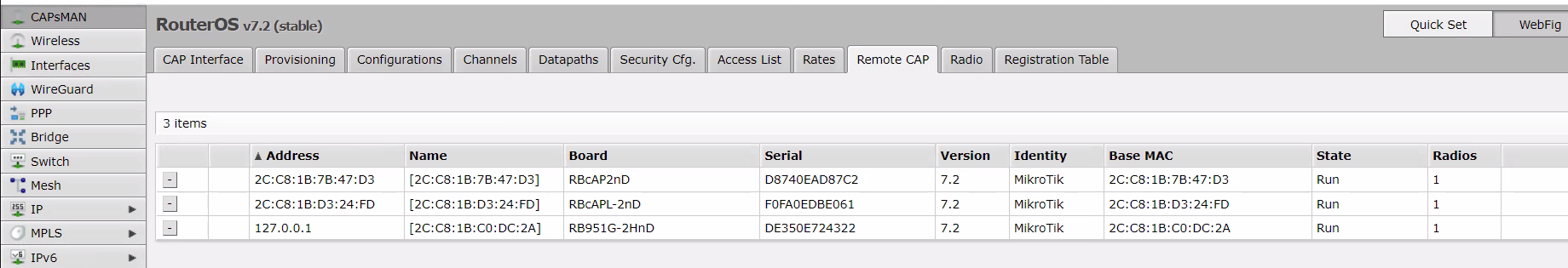

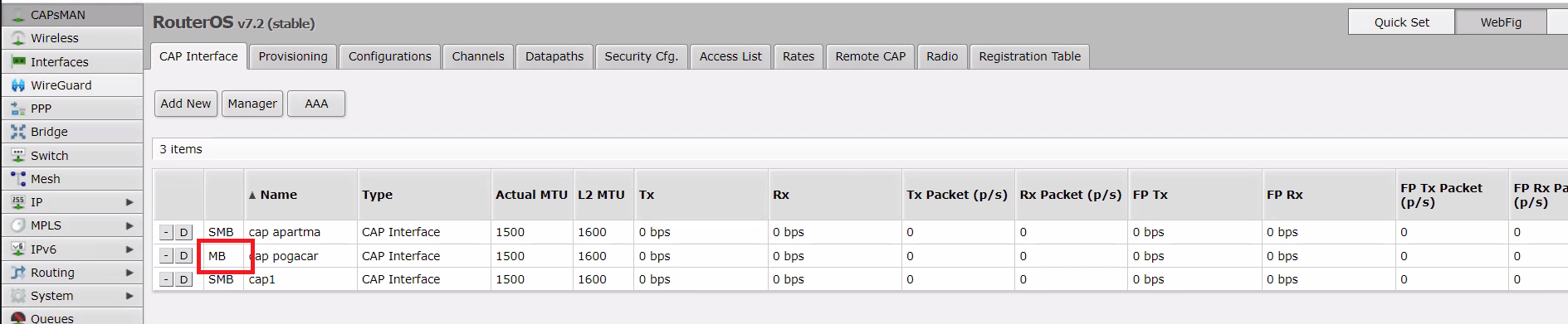

When looking through configuration I saw that the biggest difference is that cap1 (127.0.0.1) and capLite are “slave” and this new one is “master”. Is this the a possible problem and how can I change it.
I am also attaching the export of the configuration and some screenshots:
  • Attached screenshot: cap_interface.png
    You can see that “cap pogacar” status is MB, but for the others is SMB.
  • Attached screenshot: remote_cap.png
    You can see that all devices are at version 7.2.

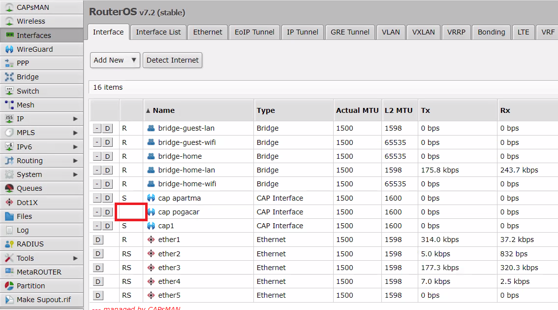

  • Attached screenshot: interfaces.png
    You can see that interface “cap pogacar” is missing “S”

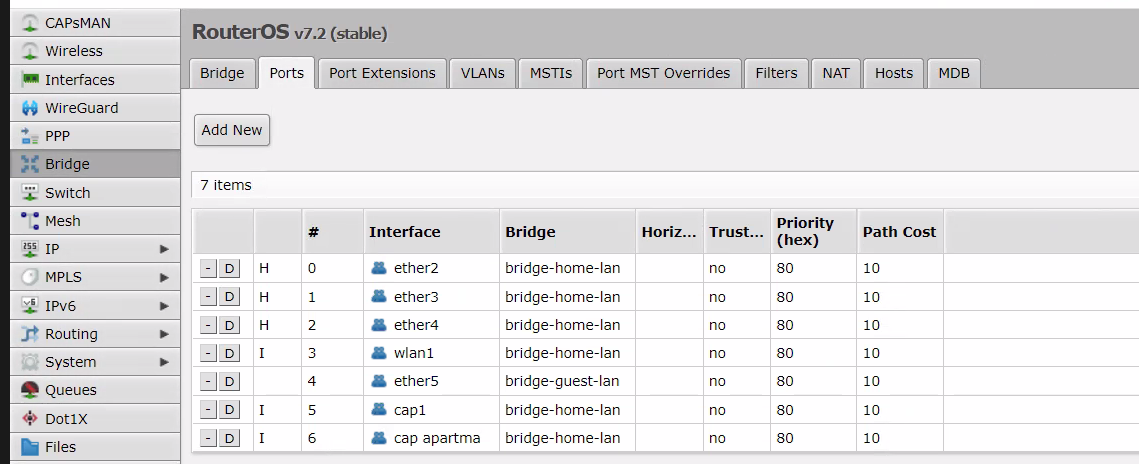

  • Attached screenshot: bridge_ports.png
    You can see that “cap pogacar” is missing.
