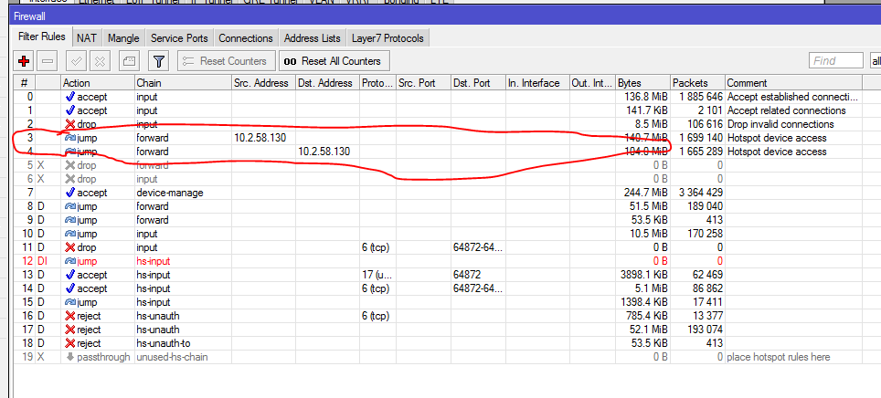

I have same problem. Where do the rules go in the firewall rules. I also use ubiquiti products as ap behind a mikrotik router running Hotspot.
The rules I have listed above go under “Filter Rules”
