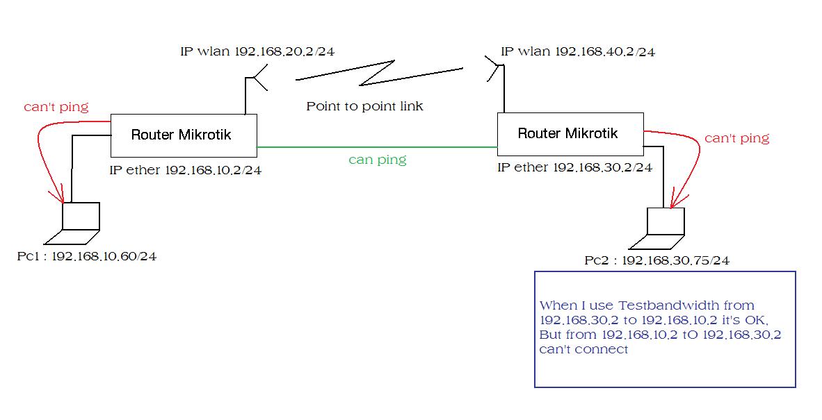

can't ping from RouterOS to PC
Hello ,
Help me please I have a problem with ping , and also I don’t know if
necessary to use routing RIP, just for point to point link .
thank you

This is my problem in this picture, any idea please

Firewall on PC if Windows
Agree with jrecabeitia. By default XP (since SP2) blocks ICMP Ping. Turn off the XP firewall. It might work then! If you need the firewall on, but wish to be able to ping, then you can modify the firewall rules on the XP client to allow ICMP pings.

Hi
But is only firewall can block the ICMP , and please if anybody have
a suggestion for a configuration possible for that network, I’m
a beginer
The two ends of the links and the PCs are all on completely different subnets. That is your problem. They will not route traffic between them, unless you put some changes into place. Either make all equipment have the same shared subnet or add routing.
Ron.
sorry for beeing blunt, but you have to have some networking background (well, some more than you currently have)
so this is good idea to go to that page and study how routing is working and what routes you should set and where. Then this all will be clear.

Thanks nest it’s Ok now
