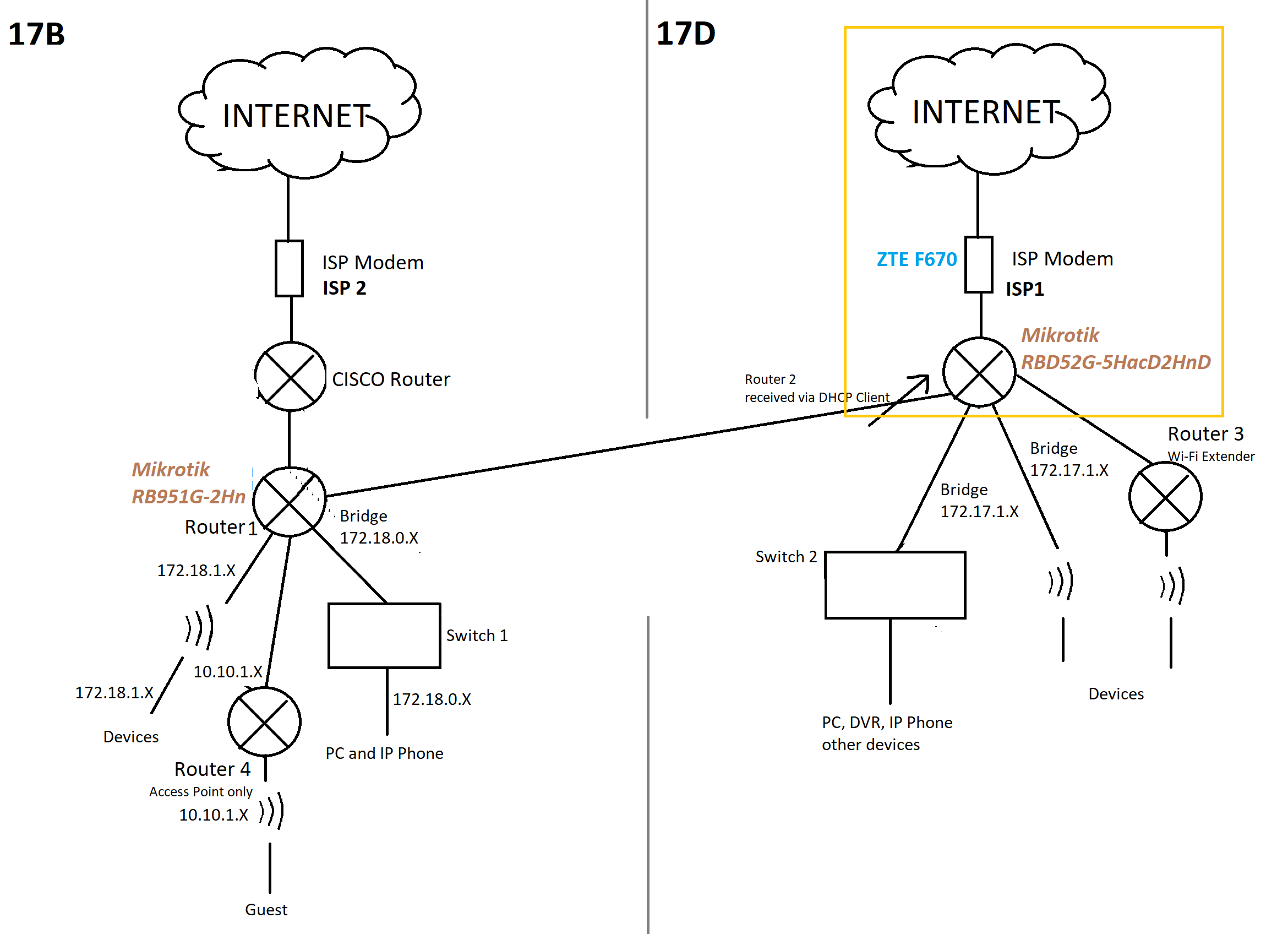

Hi thanks for the response.
Herewith the code and picture of topology

Sorry for the messy image and a little bit complex just in case need the whole network topology.
I marked the focused area with yellow box.
If need more information or need me to simplify it, can just ask.
Thank you for your support
Picture clarifies a lot.
So the problem is ping from router2 to ISP1-modem, correct ?
