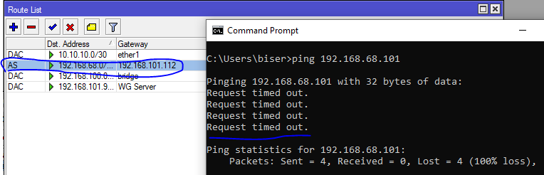

Hi, this is the config below. Everything is the same, only 192.168.68.0/22 has been changed to 192.168.68.0/24. WG is connected, SR2 can ping everything behind the Mikrotik, SR1 can ping only the WG adapter address(192.168.101.112) on the SR2 PC, but can’t ping LAN adapter IP: 192.168.68.101

add disabled=no dst-address=192.168.68.0/24 gateway=192.168.101.112 \

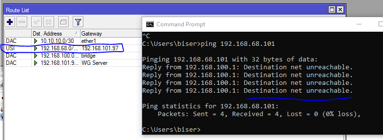

  • So, the WAN network in the lab (10.10.10.0/30) is not a problem, it is just needed to establish a connection between MT and a 3rd-party router. The connection between the WG server and the WG client is fine, no problem.
  • If I change the route to the WG gateway instead of the WG client, the route becomes USI.

I changed as you said, but the result is:
Im sorry i need to see the config to make assessments of the changes made.
This is the config;
