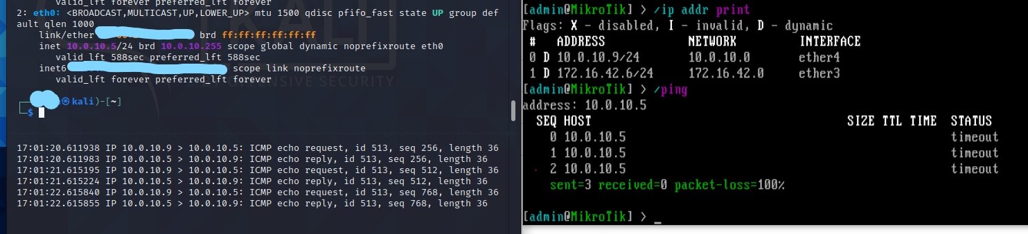

I’m having the following issue on a Mikrotik 6.40.4
Both devices are in the same Nat Network. Both of their firewalls are set to accept.
I cannot ping from debian → mikro
When I ping from mikro → kali, it reaches kali (as seen in the tcpdump in attachment). But upon return, the mikro drops it for some reason.
I’ve tried with other OSs, as well as other mikrotik versions and have had 0 issues. It appears to only be this device.
Attached is a visual of the issue I’m facing. On the right is the mikrotik, and on the left is the debian device.
Any help would be greatly appreciated, thank you!
