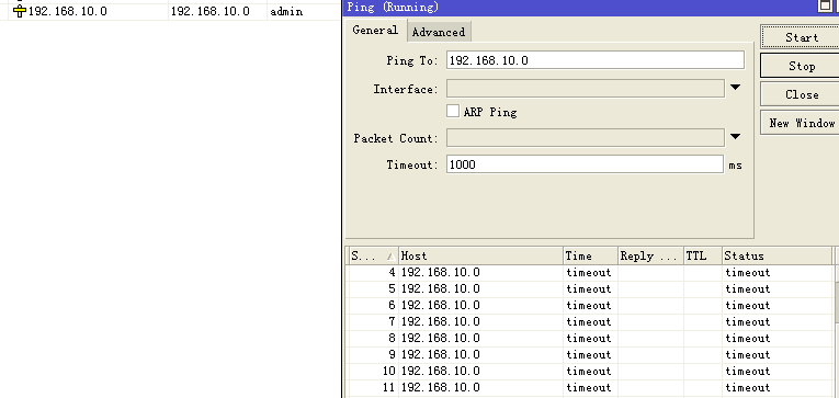

can't reuse "used" netwrok address , bug?
version x86, v6.43.7
lab 1
step 1 add 192.168.10.1/24 at one interface ( ping 192.168.10.1 ok)
step 2 delete 192.168.10.1/24
step 3 add 192.168.10.0/32 at the same interface (ping 192.168.10.0 fail fix it only reboot routeros )
lab 2
step 1 add 192.168.10.0/32 at one interface ( ping 192.168.10.0 ok)
WHY?

no other setting, and only ping from himself,
I know about the available address, so step 2: remove 192.168.10.1/24 , step 3 : assigned the 192.168.10.0/32 to the device
