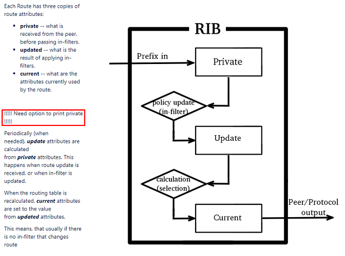

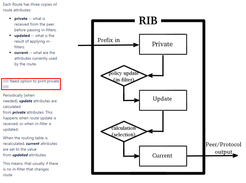

In the Route Selection section, the third item states “Route should not be synthetic.”
I am not familiar with the term synthetic route, and google wasn’t particularly helpful, with almost all references to organic chemistry reactions. Even the search synthetic site:mikrotik.com only finds the reference above, plus some entries concerning synthetic interfaces (related to VMs).
Does anyone know what this Route should not be synthetic means?
There are some other oddities in the article, for example what appears to be a “note” left by the writer that there needs to be a way to print private attributes.
