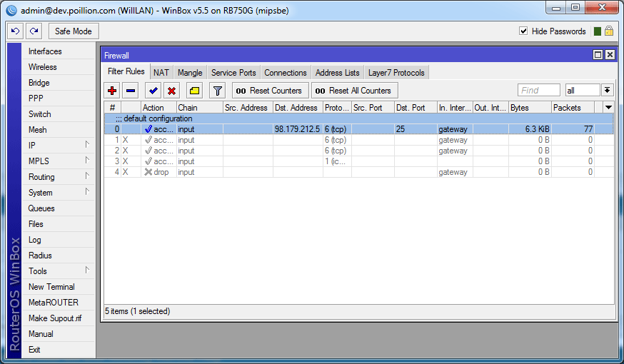

Ok, I have it setup exactly how it was explained. Unfortunately, I still can’t get in. The error is simply “Network error: Connection Timed out”.
I’ve attached supout.rif (renamed to supout.txt so I could upload, rename back) and two images of my Firewall window, one is the Filter Values and one is the NAT.
All I want is ssh to work with port 25. I was thinking I needed udp as well so I put that in an forwarded it to the server with 0-65535 ports open.
Any suggestions are greatly appreciated!

Export your firewall and paste it here.
/ip firewall export
