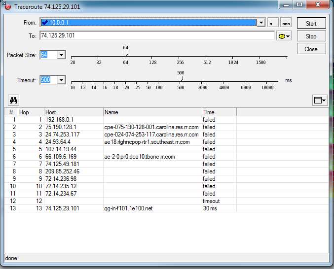

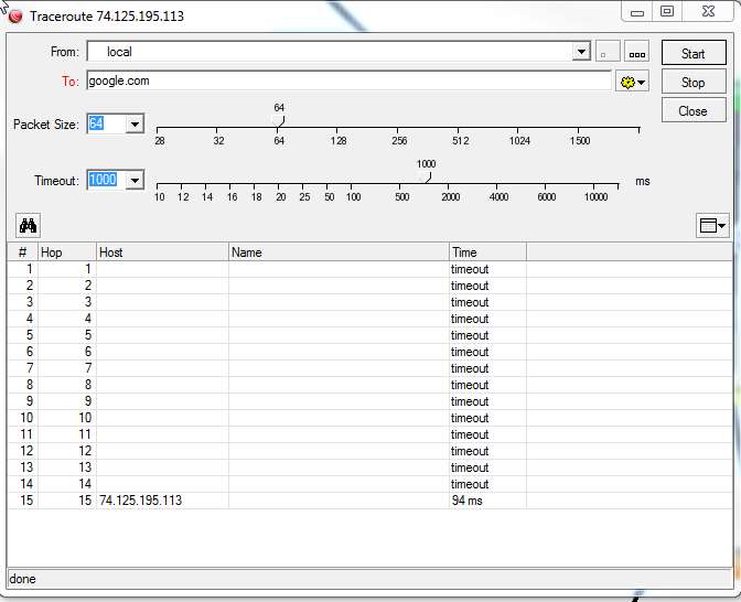

I’m getting different results based on source.
Config: Internet | Nat device 192.168.0.2 | Microtik router 10.0.0.1 (with dude agent installed) | Computer on 10.0.0.x subnet (with dude windows client running)
Depending what source is listed having different results.
