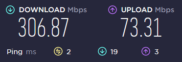

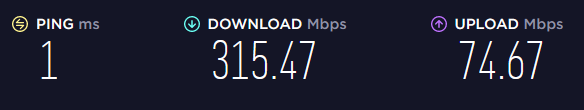

I have been using cAP ac for several years now. And since day one I have noticed that the 5 GHz upload speed is much slower than the download speed. I don’t use 2.4 GHz at all so I haven’t tested the difference between upload and download speeds with 2.4 GHz. And I use cAP ac only as 5 GHz wireless router, the ether2 port is disabled.
Below you can see the difference between download and upload speeds using 5 GHz. And to be absolutely clear, the ISP provides the same upload and download speeds, i.e. if I connect the computer directly to the WAN cable, the upload speed is almost identical to the download speed.
Although it does not bother me much, I would like to understand why such a problem exists at all. I have reset the router to default settings several times over time, I have always used the latest version of the RouterOS, but it has never been clear to me whether this is the problem with RouterOS itself or configuration settings, or maybe my router has some hardware problems.

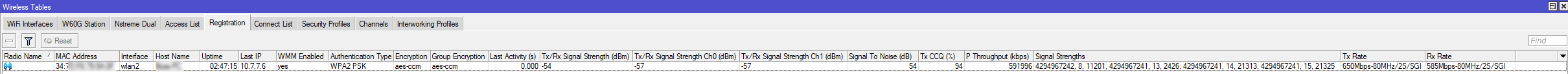

Can you please share the connection speed (wireless, registration, tx/rx rate)?

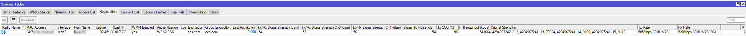

Sorry for the late reply. Here are three results:
When downloading
When uploading
When idle

Well most of the wifi information is there in the “registration” screenshots.
Signal is OK, Signal to Noise is OK, CCQ is OK.
The interface rate varies over time, but lets take the first screenshot
No major reason to expect low performance from the upload (Rx rate) , compared with the download (Tx).
It is not “perfect” , as that should have been “866Mbps-80MHz/2S/SGI”. So there are some missed transmissions, that make the devices downgrade the MCS.
Download is MCS07, while upload is MCS05 (but these values do vary over time and are load dependent.)
To find out where this comes from, the first hint is in the Frames/HW Frames ratio. HW Frames are the # of frames transmitted , Frames the # that made it succesfully.
Should be fairly good with the high CCQ.
(better screenshot with “detail mode” ? Or just some columns can be hidden)
But this will not explain why the upload is so much slower, it could account for some reduction but not 4 times lower.

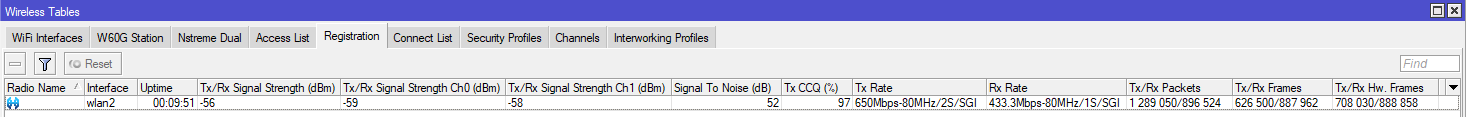

bpwl, thanks for the detailed explanation. Here is a picture showing the HW Frames and Frames columns, looks like Tx HW Frames and Tx Frames are quite different after three speedtest attempts.
Most information is there, not all with MT (eg AMPDU and AMSDU aggregation?) , and interpretation is not at all easy.
I have no clue on what triggered your slow upload.
The rest is just all speculation.
The extra data learns that in TX some 11% did not arrive at the first attempt, for whatever reason. Not too bad, as the standard MT hardware retransmit is 7 times by default.
The 97% CCQ learns that it quite often succeeds within the 7 attempts.
The RX is even cleaner, with almost 100% first transmit success, but only one stream is used now. The interface rate is also the max rate possible for one stream (433Mbps)
MT is not giving aggregation numbers, but if the packet/frame ratio could be used as indicator, it would mean that only the TX is using A-MSDU and/or A-MPDU aggregation.
Maybe the number of TX and RX bytes then learns about the packet size.
Not using A-MSDU or A-MPDU aggregation would limit the net throughput! With a 433Mbps data rate, and a 1500byte transfer size , the max net data rate is 44,2Mbps when a 6 Mbps base-rate is used. (https://gjermundraaen.com/thewifiairtimecalculator/).
But MT is not giving us this information, so it it a lot of speculation and guessing, and the average ratio’s are not the ones for the transmission itself.

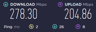

Just to let you know, if anyone else has had a similar situation, I discovered the cause of the problem quite by accident, it’s the “fasttrack-connection” firewall rule. After I disabled this rule, the 5GHz upload speed “skyrocketed”. Even if I disable the “fasttrack-connection” rule at the moment when the upload test has just started, it starts to increase significantly.
FastTrack enabled.
FastTrack disabled.
Thank you for sharing. I’ll keep this in mind next time I am working on something similar.
So disabling this, to get full speed upload, even without reboot. ???
Interesting. Can anyone explain? (Things like, “not all packets are fasttracked, and the same regular rule is needed” … ???)
Fasttrack is supposed to be faster. Just wonder: Do some packets get dropped or mis-directed? ROS7.2.1 specific behavior? hw-offload related?
https://wiki.mikrotik.com/wiki/Manual:IP/Fasttrack
Yes, I watched one video about the “FastTrack” rule that also explained the cases when it is better to disable it. So, out of interest, I disabled it and ran a speed test without restarting router.
And it looks like this rule only affects the wlan2 (and maybe wlan1 too) adapter. A couple of months ago I did a test by connecting a computer with a network cable to the ether2 port. The upload speed was exactly what it should be. At that time, the FastTrack rule was on.
