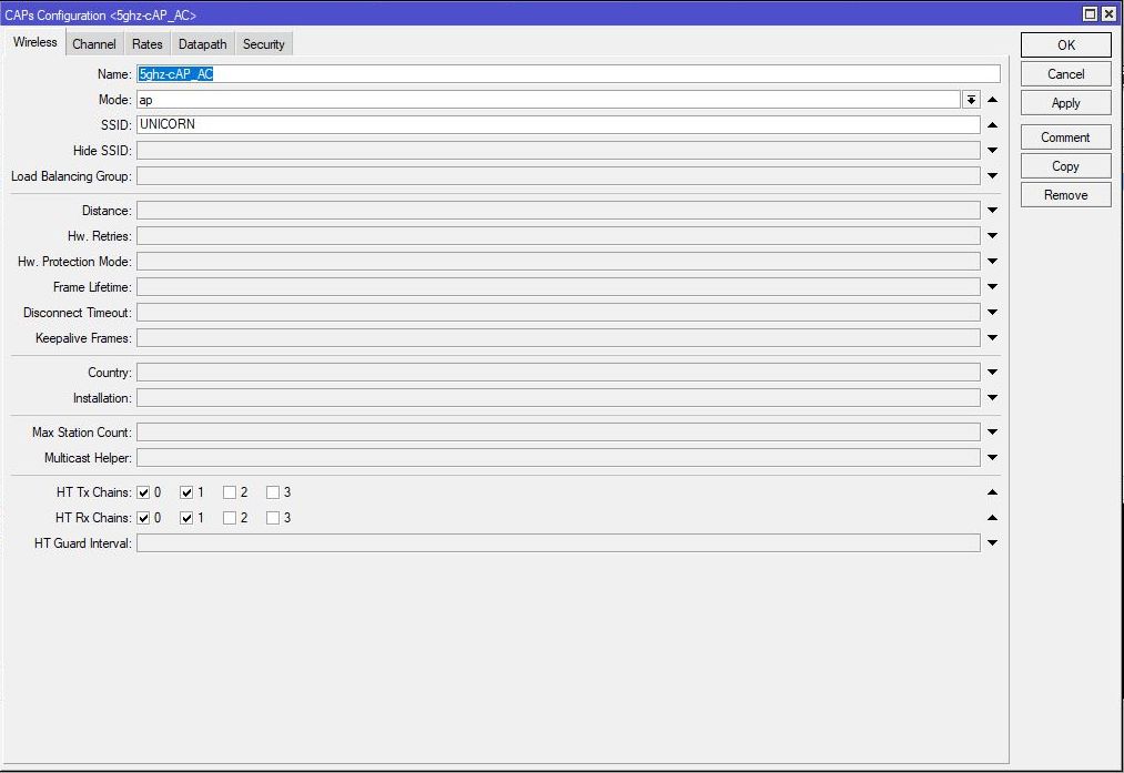

Hi… I have cAP AC as CAP connecting to RB3011 with CAPsMAN. As soon as I enter COUNTRY to CAPsMAN configuration, the 5GHz WLAN on cAP AC will not connect. Whe removing COUNTRY, it connects and working.

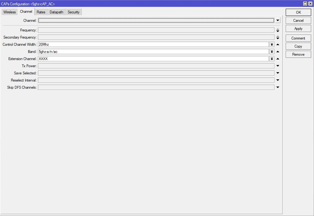

Did you configure your channel manually?
no.. i have auto channel…
and i forgot to mention.. the same config works with hAP AC which I have on the same network. when i add country, it stops working. note, that 2.4GHz is workign with country set

In most countries, 5 GHz channels are subject to regulation, which usually classifies them as “indoor” and “outdoor” ones, so the installation parameter of the caps-man configuration also plays a role. But first of all, most countries require that the device was listening before using certain channels, for as long as 10 minutes, before starting to transmit, as the frequencies used by meteoradars fit into the 5 GHz band. So maybe it is enough to wait for 10 minutes and the 5 GHz interfaces will come up? Also, aggregation of 4 20-MHz channels (XXXX) is possibly prohibited in your country?
