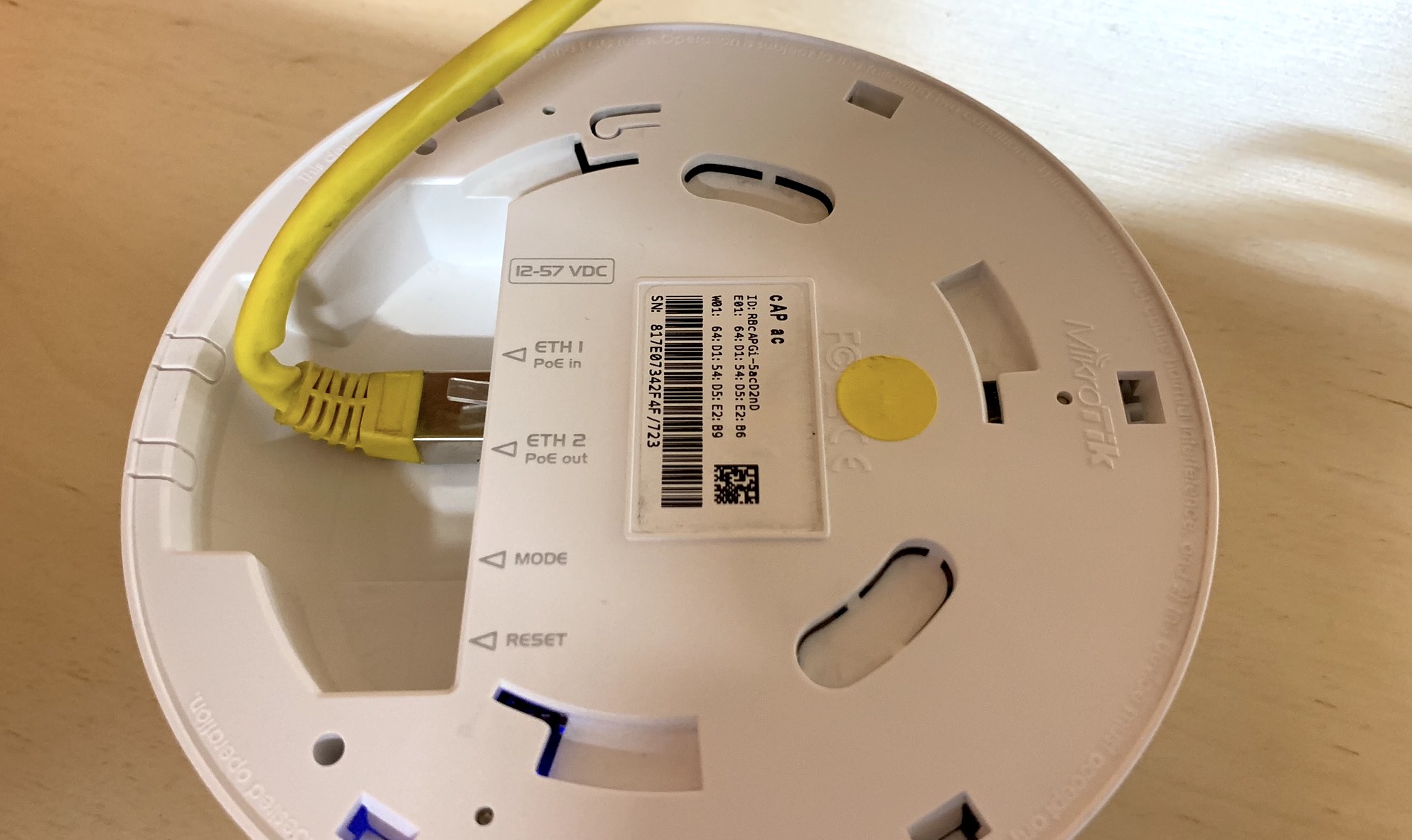

am I the only one that hates cAP ac mounting brackets?
  • It has no protection against theft. You can simply turn it and hold it in your hands within seconds. Take a look at wAP ac´s mounting. This would be fine.
  • Mounting at all is crucial. We have network connections within the wall. There´s no hole coming from the wall behind nor coming anywhere from the top. On the cAP ac there are notches where you should get in your RJ45 patch cables. But the angle for connecting the RJ45 connector is too big. So we use flat cable.
Kind Regards
Bracket is fine for me but why no designed holes for cables coming from side of AP rather then from behind it?
Ditto, design is horrible is certain situations. Not much room, especially if you use both LAN1 and LAN2.
Can you clarify about the cable not bending enough to fit into the wall? I just don’t see the issue.
Here is one with a fat factory made cable. Normally you don’t have such fat connectors going into the wall, this is worst case scenario.

I’m trying to mount it on a foot thick wall that I can’t easily drill or run cable through. So, I thought I’d run the cables on the interior wall using a conduit (just to look neater). I’d like to see a mounting bracket that can mount on an electrical junction box.
